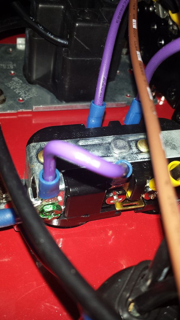

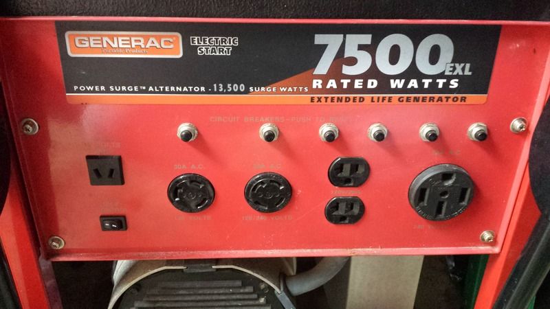

hello,
im hoping this is a simple question and answer for my situation. i opened up the face panel to my generator to look for the bonding wire and found it.
what i also found was that my L14-30 outlet (which is what ill be using) has no ground attached to it?
what i am confused about now is if the 240 volt L14-30 outlet is a bonded outlet or not? i am looking for any answers someone may have (simpler the better ). is it just because its not a bonded outlet???

If the receptacle is attached to a metal mounting plate then it is grounded.
Old 01-31-16, 08:46 PM
L
Join Date: Nov 2015
Posts: 1,550
Received 92 Votes on 80 Posts
Ground of the outlet is grounded to the frame of the generator through mounting plate as PJmax said.
And from reading the manual and looking at circuit diagram of this generator, Neutral is grounded (bonded).
You can also see that from your 1st picture showing duplex 120V outlet. See purple wire jumping from neutral to ground.
The generator is not really grounded until it is connected to grounding rod or house ground.

If your generator had GFI circuit breakers..... you'd need to be observant of a neutral bond because that would cause the GFI to trip.
Your generator uses standard circuit breakers.... don't remove any jumpers.

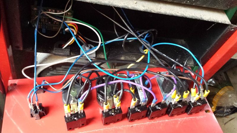

so, it appears i have a generator wiring problem? should i return the purple bond wire??
top 120 outlet. all 3 were lit?
bottom outlet. hot neutral reversed

It would seem your tester should read two yellows only if everything is correct.. ( from the diagram on the label. Try that device in your homes outlet somewhere as a test and let us know what lights come on...

Yes, correct. In the house the device is working as it should. 2 orange lights. When I placed the purple bond wire back in the 2 orange lights came on also (as in correct)

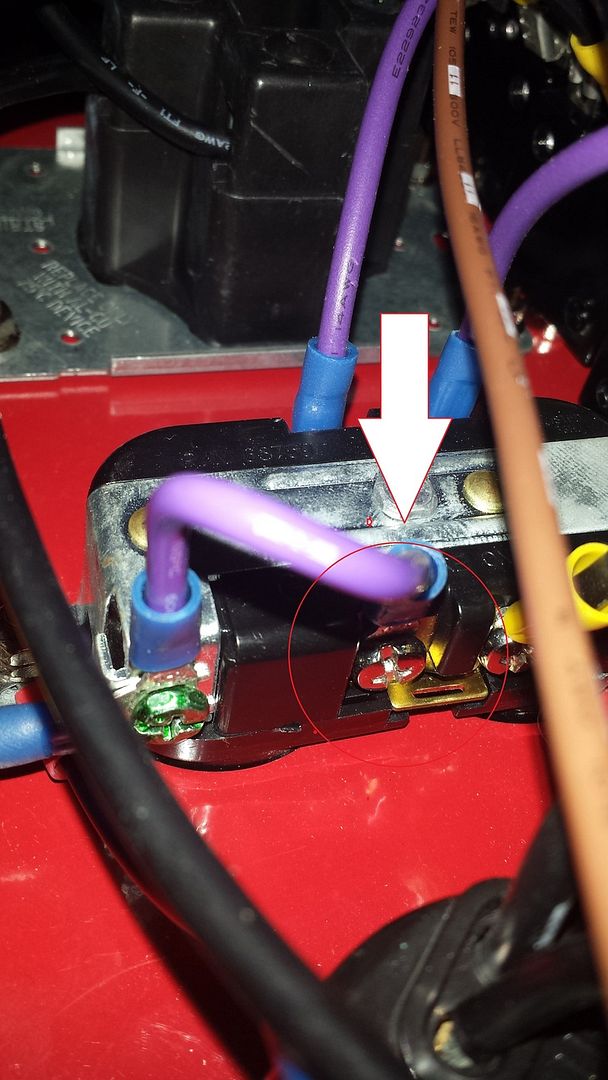

I dont think thats the correct wire to lift.. You lifted the purple one on the duplex?
With proper bond lifted on gen you should show open ground..Like my gen with a floating neutral this is what it shows..
Once I plug my gen to the home inlet/tranferswitch it gets its bond there. Then lights show correctly connected...

I assume there are no tabs on that duplex???

yes,the purple wire is the one i lifted (and now replaced). and yes, it does have the tab intact.

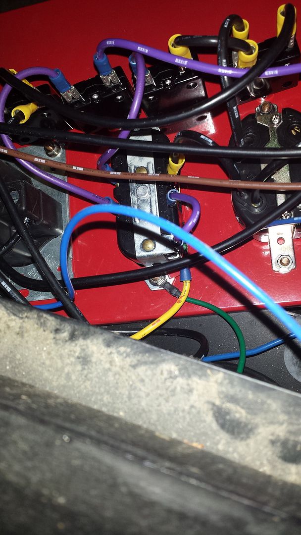

It states in that link that the grn wire from the control board should be relocated from the ground to the neutral... Did you see that?
The yellow looks like it attaches to the ground of the rear carrier bearing..
On the 120VAC duplex outlet there is a jumper between ground and neutral. It must be removed. This is the bonding wire. Next, look for a green wire coming from the control board inside the electrical panel. It connects to the 120V 30A L5-30 twistlock outlet. Relocate it from the ground to the neutral connection. This will ensure the auto idle circuit operates properly.

that was the wire i removed (purple bond wire) that caused the tester to read the hot/neutral reversed and having all lights on.
that yellow wire leads into the DC motor right below.
EDIT,YOU POSTED AGAIN
i see that now, the neutral will now be the screw on the receptacle with the connected tab correct?
this one?
this one?
Yes that tab connects both.. So after you remove the purple wire the bottom plug id still connected to the nuetral from the plug above.
There is no reason that your tester should read different... Unless I am missing someyhing...
And that green wire it states to move that from the ground to the nuetral where you removed the purple wire.. Thats to keep the idle control working...

well i moved the two wires as directed and it seemed to work!
both orange lights lit but i got a real faint red light too.
i did not test anything on it (plugged something into it) as im not sure what i should do next? i figured i would wait for advice on here instead of frying something else.

With your tester plugged in to the gen and generator running you get two yellow lights?
yes, two yellow lights with the red faintly lit
Is this test with the bond lifted?
yes,i removed the purple bond wire and placed the green wire onto the receptacles neutral
And is this with nothing else plugged into the gen?
correct, nothing is plugged into the genny but the tester

Well you should show open ground with the bond lifted..

Something is wrong then and the bond is not yet lifted...
