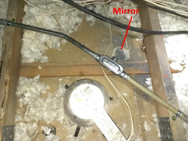

The previous property owner had put in this elaborate mirrored ceiling with wood framed in sections.
Only problem is, there is a junction box above this ceiling that's covered up.
I would like to access this junction box somehow.
This is the junction box from above in the attic. As you can see there are several EMT conduits connected to it and there is no easy way I can turn it around and make it accessible from the attic side.
Any ideas?
Do I measure carefully and cut the mirrored ceiling from below then put in an ugly box cover? Assuming I don't end up cracking the mirror and once I do that there is no avoiding taking the whole thing down.
Or is there a way I can do something in the attic?

I would not touch that.
Are all those lines going into the box on the same circuit? If so just leave them be.
Why do you need access? If we know that we might be able to better advise you.
Do you need another tap to run a light? Or do you want a power outlet? What is the amp rating on the circuit? What to all the lines going into it operate?

National Electrical Code requires that ALL (my emphasis) junction and pull boxes remain permanently accessible without removing any part of the building. (Article 314.29 NEC 2002)
I see no other solution but the tedious re-routing of all the conduits and wiring from the attic except the one of making the attempt to add a removable cover plate from the room. The person who did that should be shot. Just my opinion.

I need access because I want to see how things are wired inside that junction box. I have made corrections to some really questionable wiring in this house (for example, splicing without a junction box in wall cavities, use of two 600W dimmers side by side without taking into derating in a crowded junction box with the 600W dimmer controlling TEN hi hat lights with 60W bulbs causing the dimmer to literally melt, connected microwave, refrigerator, dishwasher and a wall receptacle to one single 20A circuilt etc...) basically I am not going to sleep well until I traced every wire down.
So yes I need to see what's inside that box and how things are wired.

OK I have been thinking about it and I think it is a bad idea to try and open up a hole from below. There is too big a risk of a disaster unless I want to take the whole mirror/wood thing down.
In the attic, I have already tried to pull up the box, it won't move. I am guessing a nail or two through the side into the furring or joist? Not sure.
Here is one I am thinking about.
(1) Unscrew the set screw connector on top of the junction box and pull up the EMT conduit away from the connector, once I have a little bit of space, cut the conductors at the separation. Repeat until all four EMTs are off the box and the conductors cut.
(2) For each conduit, go back 8-12" on the conduit and cut it with a tubing cutter. Pull off the short cut piece. This will leave me with four truncated EMT conduits with 8-12" of extra conductors.
(3) With all conduits disconnected to the box. pry out or cut out the junction box and see how things are wired on the inside.
(4) Connector each truncated EMT conduit to a metal handy box. Four EMT, four handy boxes. From each handy box, splice and run new conduits and wiring to a new junction box closer to the attic access hatch.
Can you think of a better or easier way?

That looks like a good option, but I would switch over to NM-B from the handy box,no need for EMT as far as I can see.

Using a tubing cutter is going to leave a big (and sharp) burr inside the conduit. You will need to deal with this to prevent it from cutting the insulation on the individual conductors after you cut the conduit.
You may not have much wire available in the box to allow pulling the conduit out of the connector. I would definitely add number or letter labels to all wires on each side of the proposed cut before actually cutting. The chances of repeated colors is very high. You will need to cut the conduit back to a point where the added box can be secured to more than just the hanging conduit.

If that box is mounted with 2 screws or nails from inside, you will be able to cut with hacksaw or some other metal cutting saw.
If it is mounted in someway that you have to have access from below, grinder might work out too. You can grind and cut attached side of the box.
In most extreme case, you may be able to just cut the box itself, but there is risk of damaging wire inside. (Make sure power is cut to the box first).

Just brainstorming. You might try cutting the conduit by going around it (360) with a Dremal. Go around it two or three times, deeper each time, till you just penetrate. with luck you may not damage the wires and if you slightly nick the insulation maybe the insulation would be repairable with heat shrink tubing.
I'd probably give a shot at cutting the back out of the box with a dremel but I doubt that would work.

I would like to keep things in EMT if possible. The previous owner had made modifications and done renovations and every "new" is NM-b so I'd prefer not to "mix and match". I don't want a run to be EMT to NM-b to EMT. Besides, most of those EMTs don't have ground conductors in them so I wouldn't want to break continuity.
If I am able to remove the back of the box using some tools...no way I think I can with all the EMTs there, I would have to move those out of the way first somehow...I am not so much worried about removing the box once I disconnected everything from it as long as I can figure out the wiring inside the box I can abandon the box in place.
Yes cutting with a tubing cutter will make a burr that can easily cut the insulation. So I need some way to file them down with the conductors there unless I can pull them back enough for me to use a deburrer. These are very old solid conductors from the 60s so not always easily pull back.

Well I spent a few hours in the attic in a "pretzel" position.
After disconnecting all the conduits to the box, I was able to reroute two circuits via another conduit, and found out one circuit actually dead ended in the box. So I end up having to connect two conduits with only two #12 conductors - one hot one neutral. I ended up using a metal conduit body and two short pieces of EMTs. The metallic conduit body can provide ground continuity...right?
Correct. However only conduit bodies marked with the cubic inch capacity may be spliced in. Also the unused opening needs to be sealed.

yes I had a plug for the extra opening.
As far as splices I don't see anything on the body itself. It says E-121488. I have four #12 conductors in there and 2 wire nuts.

To provide access to conductors for pulling,
splicing, maintenance and future changes/
upgrades
Sounds like it is OK for splicing
