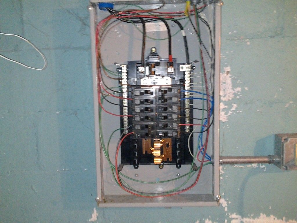

Have pics hope they come out ok. New panel in basement under kitchen.
Old Panel on main floor.
Old Panel close up. Much worse than pic. Green wires open. Inside Right above panel old live wires with wire nuts. To much to say here.

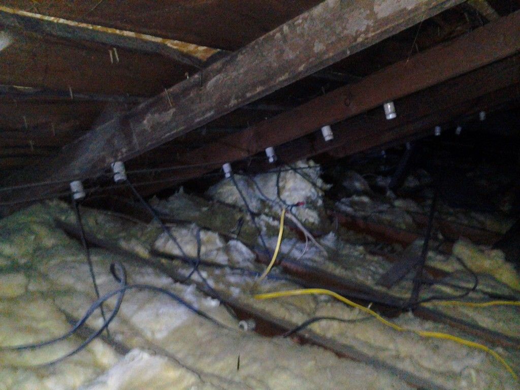

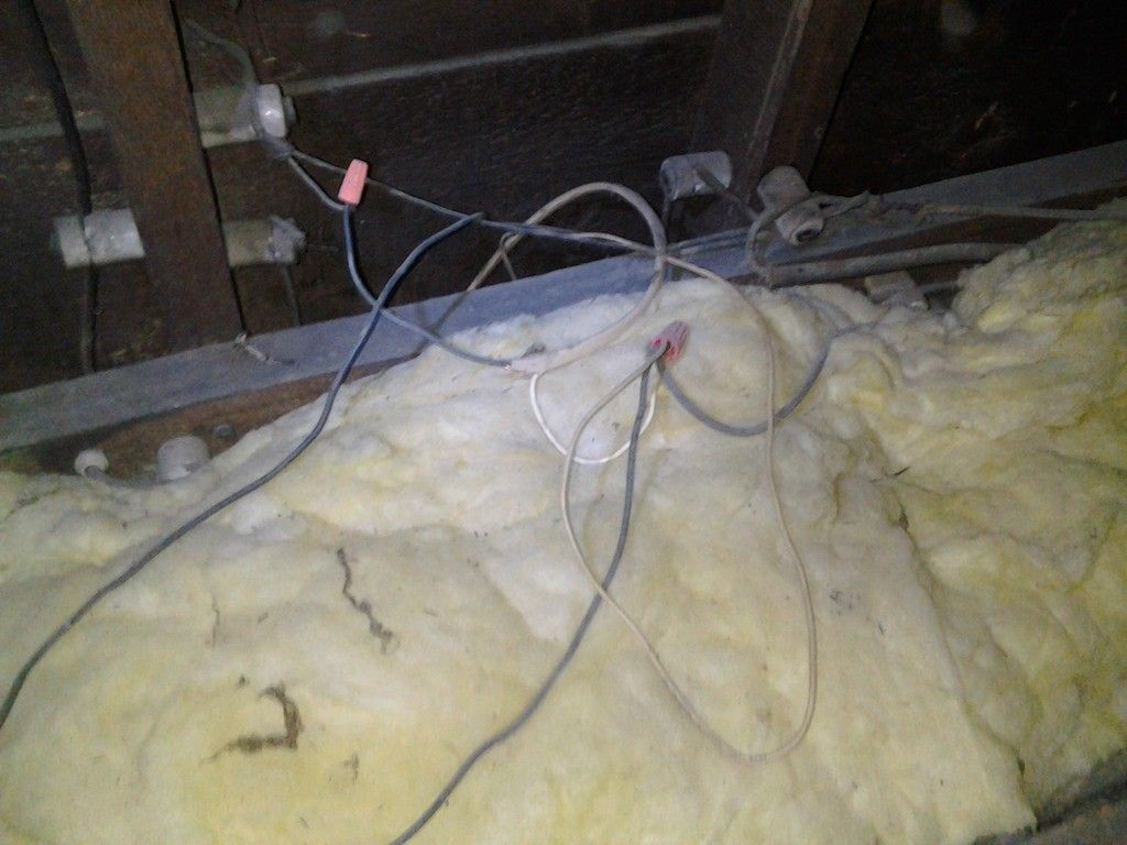

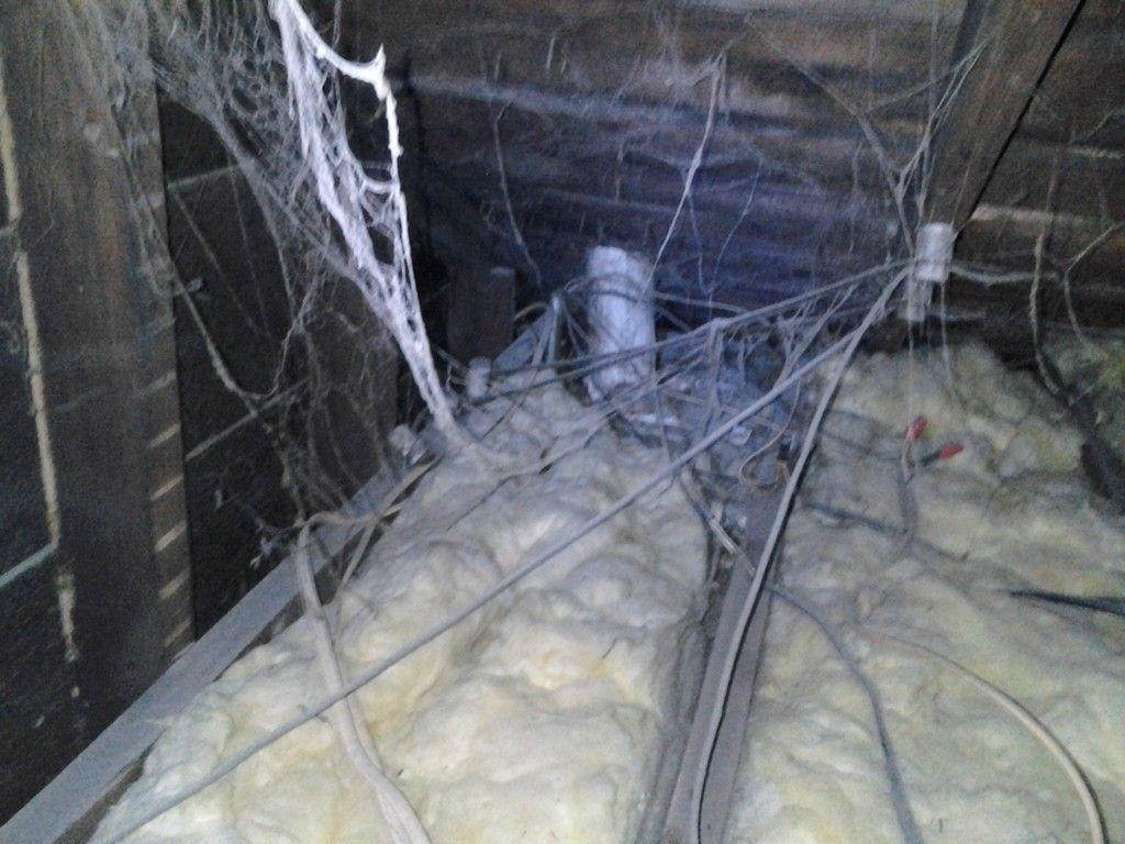

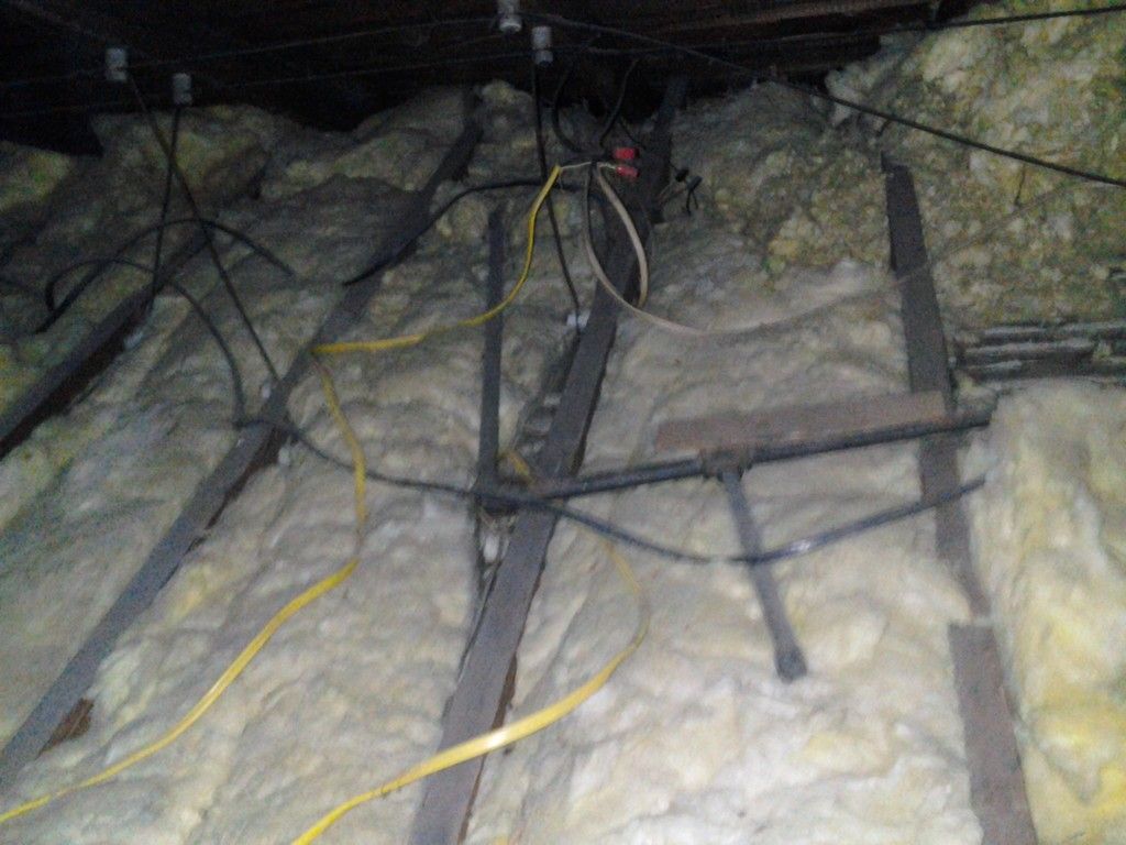

Right above Old panel in attic. Newer wires coming out and much more.
Attic
Attic
Attic
There are many more wires running across attic floor with open wire nuts. A huge mess.

Question is can I use the old panel Pics #2 and #3 on the main floor as a junction box? All wires going Down from the old panel are going to the new panel and are new. I could then run cable up to attic from the old panel. Can change old panel to "other" if needed. Can also change the outer door in pic #2 if that is a problem in any way.
If able to use old panel or other in some way. There are two flex conduits running from basement new up to old panel. EACH conduit has 3 white wires, 2 black , 1 red and 1 green. Can I switch out the red wire for a black (red has a cap on it and not used) and then run some grounds up to make the switch over to cable? Can you use bare grounds in the flex conduit?
Do not understand why someone would run this with only 2 grounds run up.
Thanks much
Yes.
I'd fasten it with screws and label the outside, "Junction box, no breakers".
No need to change out. Any color but white, gray, or green is an acceptable color for an ungrounded conductor (AKA a hot wire) Different colors (black, red, blue, yellow, etc.) are used to identify hots of different circuits.
Only one ground sized to the highest amp circuit is needed per conduit.

There is no need to put an additional splice in the new wirng. Just run the cablessings past the old panel and avoid a splice.
