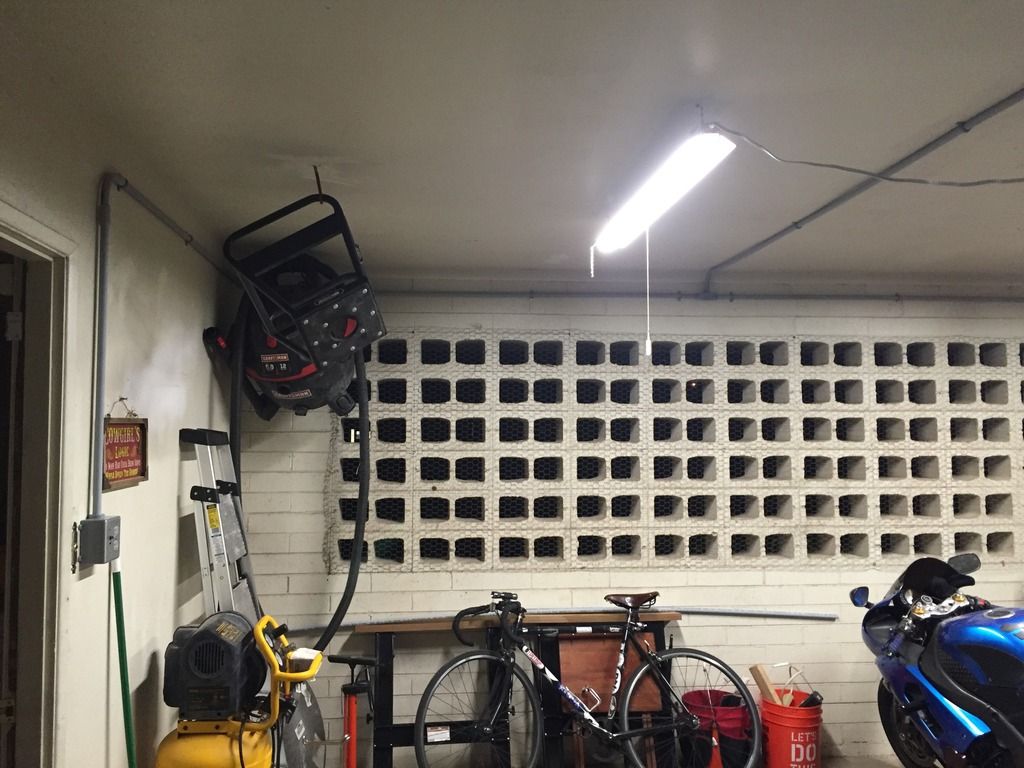

I've decided on box to box, a small run of conduit between, and 1/2" bushings on each box. I have the bits and chisels to make a hole for 1/2" schedule 40. I do NOT have badass hole saws for that solid block.

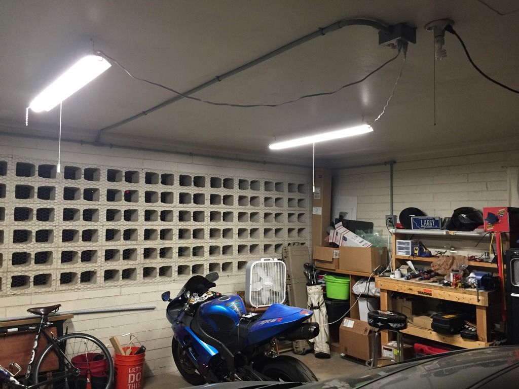

...for anyone still interested
I'm splicing in to the run next to the workbench above in a few days. I have the t-fitting capped, and extra wire stuffed in there so i can do it. I'm basically doing a raceway extension to the entry for garage for any driveway work!
Btw, these heavy duty outlets are VERY tight around plugs....

Looks good! I hope all the receptacles are GFCI protected.

No sir. GFCI circuit breakers it is...there's no way i'm getting new covers and installing 5 new outlets.

By using a GFCI breaker they are GFCI protected. Well done!
