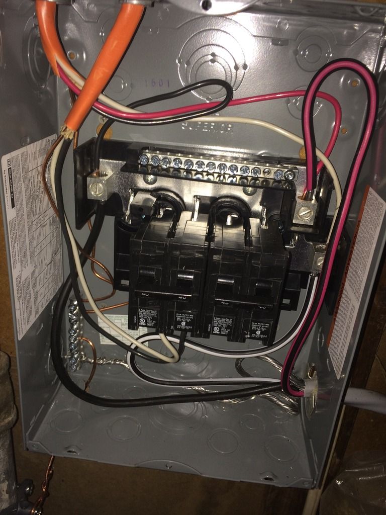

Yes the guy was a total hack - weird because he has a storefront in town and specializes in generators and home audio. Not sure how you run around town installing generators and not be licensed electrician.
He didn't even bond the 2 subpanels together which is easy. So I took all ground wires and bonded them to the sub boxes and then to a pipe that isn't connected to a water line anymore but is burried plenty deep. Then wired up 2 hots to my outlet.
Pictures attached - look right ? Wrong?

That picture is most definitely wrong. I see two smaller conductors as well as the feeder conductors going to the main lugs. The feeder conductors MAY be smaller than the minimum size for those lugs. The "right-hand" feeder connection has been made to the neutral bus and the neutral feeder connection made to the right-hand bus. The white wire connected to the circuit breaker needs to be colored something other than white, gray or green.
Was this guy drunk or high when he did the work?

Oh my god. Too much wrong. Grey cable if underground is wrong because it's SER. Double wires under main lugs, wrong. Neutral (white) to hot lug, wrong. Hot (red) to neutral lug, wrong. Black and Red are to be used as phase conductors. White is to be used as neutral. White where used as a phase conductor in a cable needs to be identified (taped) as red or black

One thing to mention which might explain the smaller connectors to the main lugs. This is the primary sub panel for the barn with 2 240v circuits. I have another panel that was existing with 2 120v circuits that was origally there.
So that we didn't need to redo the existing circuits he ran a #10 cable from the primary sub panel to power the secondary panel.
I installed the one 240v circuit today on the breaker. I forgot I needed to mark the white cable black since it carries a 120v hot to my 240v outlet.
Besides that and knowing the other cable is running to the second panel - what is left to resolve?
Doesn't matter, it is STILL wrong.
Everything I mentioned in my previous post.

Ray, I was right after all, a total hack job! The SER is obviously the cable this hack ran underground.

Wow, I hope you can find some recourse against this clown. I would need to look hard to find one thing that is correct.

Appreciate the help gentlemen and would like to resolve and learn on this one. Can we try to tackle this one problem at a time...
1 - Right now the 2nd subpanel is connected via #10 wire from the 1st subpanel 2 main lugs (neutral/hot) to the 2nd subpanel neutral and hot bars. Sounds like the main neutral/hot (lugs?) should only be connected from the primary power source (main house panel in my case). So do i install a circuit breaker on the 1st subpanel and then run the line to the 2nd subpanel instead?
2 - Two of you both made comments about the "right hand feeder" and "neutral feeder" made to the right hand bus. Can you please explain this one as it looks right to me. The panel has 2 hot buses at the top and the neutral on the right side. From the main panel 2 hot lines go to the hot buses and the neutral (black and white in the picture) goes to the neutral bus - whats wrong here?
3 - i need to mark any white wires that are used to carry a hot with black tape - in my case that is only the single 240V circuit that i installed on the left hand double breaker. Do you see any other violations?
4 - how does the grounded connection look to this group? I have all of the bare ground wires connected together on the grounding bus on the lower left of the box and then connected to a buried unused water pipe. Look ok?
Thanks for the help - and yes i'll be going after the guy to resolve the wire run but i'd like to clean up the subpanels myself so i can learn how to do this properly.
Feeding a second subpanel from the first subpanel is fine except that at the first subpanel the feeder is double lugged in that panel's main lugs and neutral lug. The feeder neutral should be termoinated on the neutral bus and the feeders hot conductors should be terminated at a 2 pole 30 amp breaker.
Yes, a 2 pole 30 amp breaker.
As far as I can tell from the picture it looks Ok.
You still have the issue of the feeder from the main panel to the first subpanel, it is definitely wrong.

Since the feeder cable is not listed for use underground you really need to rip it out and start over.

Will need to get the ser cable resolved but that will take some time.
Im clear now on how to properly connect the second sun panel.
What needs to be resolved on the feeder from the main to the subpanel outside of the SER cable?
  #29
Old 07-28-16, 03:07 PM
ray2047's Avatar
Join Date: Mar 2006
Posts: 33,575
Received 15 Votes on 13 Posts
It needs to be four wires, two hots. one neutral one ground. If the conduit install is continuous and you can get the SE out you can pull in individual wires such as THWN, 2 black, 1 white, 1 green.
  #30
Old 07-28-16, 05:47 PM
F
Join Date: Mar 2006
Posts: 18,495
Received 36 Votes on 28 Posts
Unless I am very much mistaken you have the "red" (red striped) incoming power connected to the neutral bus and the "white" (white striped) incoming neutral connected to the right-hand power lug. This is backwards, the white should connect to the neutral and the red to the power lug.
Also, while I cannot see for certain I suspect the green "bonding" screw in the neutral bus has NOT been removed as is required.
  #31
Old 07-29-16, 11:22 AM
CasualJoe's Avatar
Join Date: Jan 2010
Posts: 11,151
Received 164 Votes on 147 Posts
Furd, I think you are right. I am not familiar with that little panel so didn't look really hard at it. I suspect that with some testing it'll be found that the jackleg non-electrician used the red as neutral.
