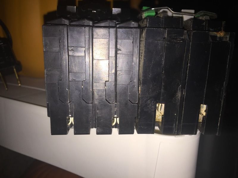

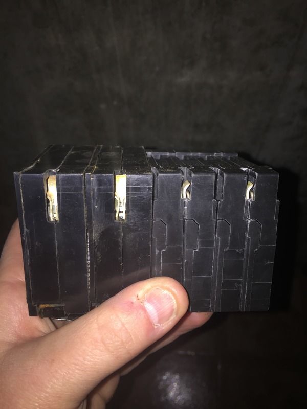

So I went to change out my breaker for a 50 amp/30amp quadplex one. I have a Murray Panel and bought a Murray breaker but it won't fit in. There isn't enough space to allow the lugs from the panel to slip into the breaker.
Old breaker on left new one on right.
Old on right..
Panel info:
Is the panel too old? Or do they make other Murray breakers??
Old 01-16-17, 02:23 PM
Join Date: Mar 2006
Posts: 18,493
Received 33 Votes on 25 Posts
You got caught by the difference between a CTL and non-CTL panel and circuit breaker.
I can never remember which is which but the bottom line is to prevent the shorter slot CBs from being used in a non-compliant panel. You MAY find that some of the "stabs" in your panel are slotted to allow the use of this style CB and if so you will have to re-arrange the CBs for this.
