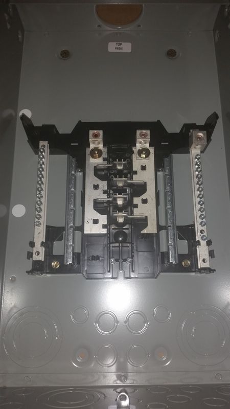

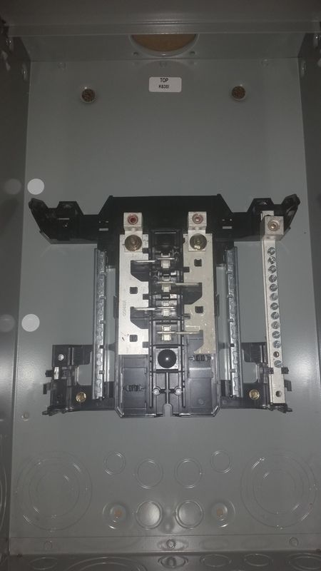

Old 02-09-17, 09:19 PM
J
Join Date: Jul 2006
Posts: 104
This is the inside of my new sub panel. I am waiting on the kit to add the main disconnect at the top, had to be ordered. This panel will be 10 feet from the main panel and attached to the same structure. I will have the four wires from main to sub, no jump between neutral and ground and no bonding screw from neutral to panel.
I purchased the grounding bar kit and now I am confused where to install it. Below are two pictures showing the bar in different locations. Is the ground supposed to be attached to the can in a sub panel? First picture shows ground in slot on left similar to neutral bar, but the bar isn't long enough to snap into place.
This picture show the bar on the box aligned with two predrilled threaded holes. This doesn't seem correct as part of the bar holes are blocked by the plastic tab.
  #27
Old 02-09-17, 10:30 PM
pcboss's Avatar
Join Date: Jul 2002
Location: Maryland
Posts: 15,218
Received 103 Votes on 89 Posts
Try moving the bar down. There is another hole below the bar on the outside left.
  #28
Old 02-10-17, 06:03 AM
J
Join Date: Jul 2006
Posts: 104
That hole doesn't line up. You can mount a 24 post bar from the top hole to the bottom. It also seems odd for the wires to turn left to attach as I have never seen them that way. So it needs to be screwed to the can or can it be attached to the plastic?
  #29
Old 02-10-17, 08:18 AM
I
Join Date: Feb 2005
Posts: 10,943
Received 44 Votes on 42 Posts
It must be screwed to the metal box. You can drill and tap new hole(s) if you need to.
  #30
Old 02-10-17, 08:23 AM
ray2047's Avatar
Join Date: Mar 2006
Posts: 33,583
Received 13 Votes on 11 Posts
It must be bonded to the metal. Plastic would isolate it.
A mainbreaker panel kit is common and always comes with a main breaker and several branch circuit breakers. Usually they are cheaper than a panel sold with no breakers. Given how easy they are to find in stores and now the ground bar problem I'd take that panel back and buy one that comes with the main breaker already installed. Examples:
http://www.homedepot.com/p/GE-PowerM...CU1K/100182490
http://www.homedepot.com/p/Square-D-...RBVP/204836335
http://www.homedepot.com/p/Eaton-125...RV10/100562920
  #31

  #32
Old 02-10-17, 09:49 AM
I
Join Date: Feb 2005
Posts: 10,943
The ground bar needs to be solidly connected to the case per code. The way any given manufacturer chooses to do that is documented in their installation instruction for the panel or the add-on kit. Some bolt to the case, some have stand-offs with long machine screws, some have short machine screws, some are spot welded or riveted. As long as you're using the right part for the panel and following the install instructions, you're good.
  #33
Old 02-10-17, 11:13 AM
J
Join Date: Jul 2006
Posts: 104
Ok. The instructions are very vague on the ground bar packaging. So the bonding screw will not suffice as the ground bar bond to the panel? I will keep searching to see if I can find additional info on the panel I have.
  #34
