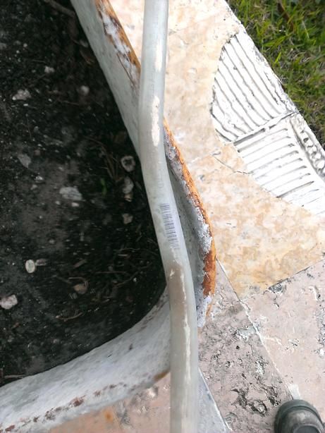

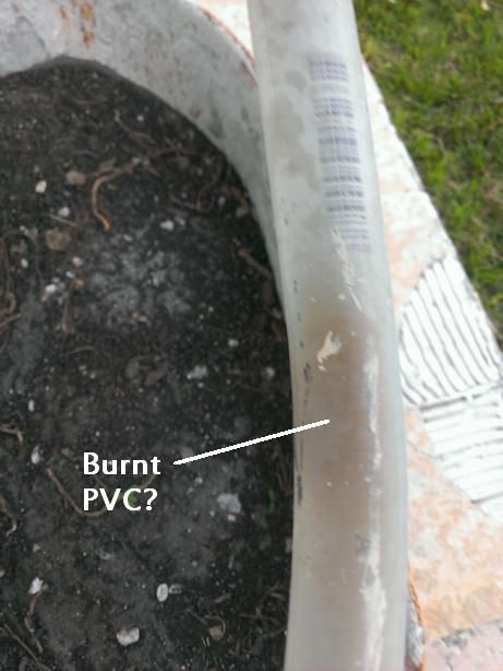

(2) I had a situation where I needed to offset a 3/4" SCH80 PVC conduit for 2". I read that you can heat up the PVC with a heat gun and put sand in it to make sure it won't kink up. I experimented with a heat gun, no sand, just hovered the heat gun 1" away over the portion I wanted to bend back and forth and I end up being able to make the offset bends. However, the portion I put the heat gun on caused the conduit to turn brown in color. See pictures. Are the brown spot OK once it cooled? I tried to redo it with the heat gun further away about 2". but that didn't heat it enough to soften it. So both samples I tried have these brown spots. Still OK to use?

Burnt PVC is ok as unless it is burned black.
It takes patient to heat conduit without burning. Use heat gun or propane torch (MAPP is too hot) far enough not to burn and move around fast.
There are special tool (sort of oven) for heating conduit, but it is expensive and probably not worth it unless you use it everyday or working with large conduits.

You can use any PVC cement on the electrical conduit. It's OK to make custom bends using whatever heat source you find convenient. Try not to narrow the conduit when making the bend. I usually just use a pair of heavy leather gloves to form the pipe using my hand after heating it over a torch. It occasionally gets a little discolored - no big deal.

I am not worried about appearance since this section of pipe will be behind walls. As long as the slightly burnt section won't disintegrate or crack easily due to the excess heating. It's not out of round or narrowed as far as I can tell.
May be because it's SCH80 it takes longer time? I will try again tomorrow another piece and see. If I can't acquire the right touch I am moving forward with it.
Try portable propane or butane stove or gas stove in kitchen if the pipe is short enough to bend in your kitchen. I found they work better because the flame is not focused like the torch is.
I found this by accident when my propane torch ran out of gas and had portable butane stove at the job site.
You are probably having problem with heat gun because it does not put out as much heat as propane and you will tend to focus heat in one place as result.
PVC conduit is paintable. So, if don't want to any burn marks, you may choose to paint it gray or same color as the wall (or whatever it is installed on).

I've used the torch method a number of times successfully on up to 1" PVC conduit, without scorching, but the best method is a heating blanket. They can be a bit expensive, but last for years. If you shop around you can probably get one at a good price.
