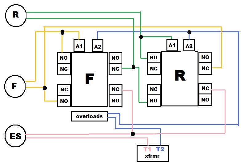

Hello, I am looking to wire up a forward reverse motor starter with estop and electrical interlock. I have the 480 wiring part down, The 110 part is the part that I am struggling with. I run my power from one motor contactor up to the transformer. I then run the 110 line to a single pole breaker and the negative to the overload? I then run the 110 to the NC on the estop, then jump a line off the estop to the NO on the forward push button and NO on the reverse button. This is the part that im get confused with. I then run a line to the NO on the forward contactor and NC on the reverse contactor. And I do the same but opposite off the reverse contactor. I then jump from the NC on the contactor to the a1 on the contactor. Then jump off the a1 to the NO ont he reversing contactor. Then the same but reverse from the reverse contactor. The second line on the over load would be from the A2's that are wired together. Does this sound correct? Thank you. This is for a classroom activity

  #21

You're getting closer but you have to have two wires on each set of contacts.
Look at the diagram. Let me explain what's going on. Once you understand what's happening you can redraw yours.
At rest.... both sets of NC terminals are closed. Both direction buttons have T1 power.
When either contactor is activated..... the opposite NC contacts open and locks out that button.
The left NO contacts are latching and the right NC contacts are interlock.
You could use the NO and NC on one side of the contactor. I used both sides for clarity.
We'll take it color by color.
Blue/T2 is connected to both coils thru the overloads.
Pink/T1 is our switching voltage. It goes thru the normally closed emergency stop switch and then goes to the interlock switch on each contactor.
Working with the normally open F button with the orange wiring. It gets its T1 power thru the NC contacts on the R contactor. When you push the F button the F contactor is supplied with power. The NO contacts are connected across the pushbutton so when the contactor is energized..... it gets held closed. Pushing the R button does nothing since the NC contacts on F are open killing the R button T1 power.
The same goes for the R button and the green path.
Pushing the ES button will stop the motor.

Thank you for that. That was easy to follow. I do have a question, is there a reason that the estop went to the contactors and not through the buttons? Or does it. It really make a difference?

It does go to the buttons..... but thru the interlock switches.
Without using the interlocks.... both contactors could be energized at the same time.
