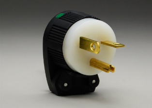

No, I'm not talking about trading in my wife guys. I'm running a new line for a deep fryer. Two tanks with separately corded elements, both 15.8 amps. The panel has plenty of room, it's at our local ball field. I neglected to check what size panel but it's a big sucker. Let's assume I'm good on that end. Should I run off a single 40 amp with 8/2 into a double outlet, or, run two 20 amp breakers with 12/2 each to their own outlets. About a 40 ft run including up and down. I'm leaning towards two 20's, minimal cost difference, easier to work with the wire, and seems like better protection on the appliance end.
Looks like all their existing wiring is romex, run through conduit up into open rafters, no conduit through rafters, back down through conduit to outlets. I was thinking MC cable the entire length but if what they have is suitable it will save a few $$ for them. Could strip the romex sheath where it runs through the conduit??

You can't run a "double size" circuit for two cords like that. Each one will need a dedicated 20A circuit. Assuming each element has a 20A plug
Like this:
You will need to install a single 20A receptacle (not a standard duplex) for each element.
You CAN install them both in the same 4" box,
and you CAN wire it as a MWBC (Multiwire Branch Circuit). This is installed with a 2 pole (240V) 20A breaker and uses one run of 12/3. You connect the red to the hot of one receptacle, the black to the hot of the other, and they share the neutral. This will be a little cheaper than two runs of 12/2.
You don't strip the Romex in the conduit. It's just a sleeve to protect against damage.

Thanks Taz, I went with a double 12/2 run of romex. Only asked about stripping sleeve for heat dissipation purposes inside conduit. Easy day.

Two separate 20 amp outlets with separate 20 amp breakers. Get a good quality 20 amp commercial grade outlets.
Commercial grade outlets have tighter better electrical connections. And devices pulling a lot of amperage can heat up [burn out] an outlet with poor connections.
If using a single duplex outlet, the heat from one outlet could travel to the other outlet. If separate, they will dissipate any heat better. (Not a code thing, just my experience.) And actually if there is a good connection, the plugs should be cool to the touch.
