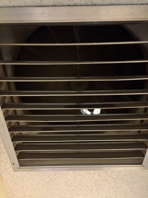

I'll take a picture of the vents in our hallway which open when we run the fan (now we have the AC going and it's 90 outside). But, in general, I think our works like you are describing. We flip the switch, there's that whooshing noise fans make when they start, and the slats of the vent in our hallway open.

Lol. I was explaining why I wasn't going to take a pic last night. Here's a pic and a link to a video so you can hear/see it in motion. For perspective, that opening is probably 6'x4'. Also, it's probably obvious to those who know how these work but there is a big fan in the dark foreground.

I didn't mean in the hallway...I meant up in the attic. You either need an active vent like I described, or a lot of passive ventilation that is open to the exterior all the time.
Looking through the picture you posted, it appears you have an attic vent fan as well?

Yes, two fans. One at the ceiling and one in the roof.
