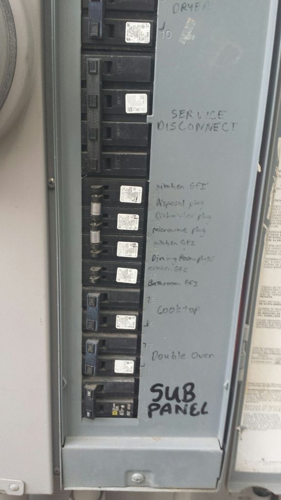

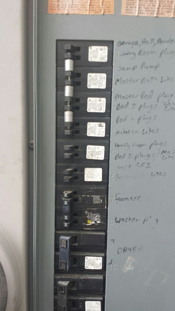

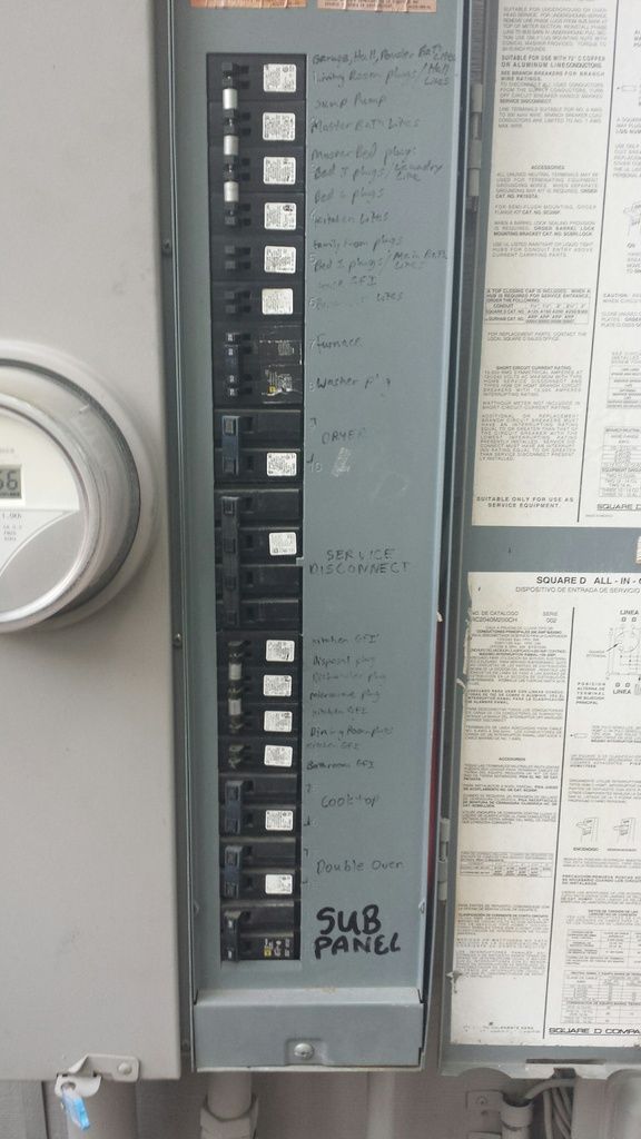

[img][/img]Hello - I'm trying to add a 220v outlet in my garage to run a new mig welder but I'm not sure if there is room in my fuse box. A sub panel had been added when the basement was refinished and another sub panel was added for the hot tub. The first sub panel is obvious at the bottom of the box. However, the hot tub is wired into the quad breaker that's labeled furnace-washer pig. Can I do the same thing again by inserting a 20-50-20 or similar quad breaker? Thanks in advance.
Old 09-29-17, 05:54 AM
P
Join Date: Feb 2016
Location: United States, Virginia
Posts: 1,436
Received 93 Votes on 73 Posts
Yes you can use additional Quads to free up space. You can change the Dryer, Cooktop, Double Oven or Subpanel to Quads to move some of the single 20A or 15A to. Don't mess with the handled tied singles as they appear to be multiwire branch circuits.

Here is where the wires originate from the main panel. Someone put in a quad 20-50-20.
