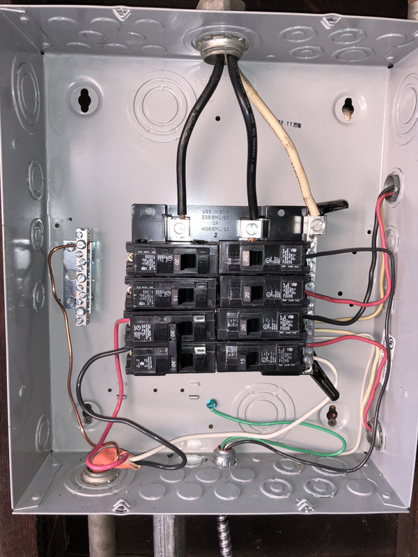

Join Date: Aug 2018
Posts: 6
Received 0 Upvotes
https://s22.postimg.cc/h6v9khbwh/1_A39_B389-_FC8_C-4_F18-_B10_C-9_FC150_E37029.jpg
So this is my panel. I already ran the romex and wired the outlet. I drew in the lines of where I believe everything should go. My last question is, do I need a ground bar installed at the bottom of the panel, or is the screw sufficient? Note: the wires here were pulled and replaced with new romex, this was what it looked like when I first opened the panel.
I'm aware I need to upgrade the breaker from 20 to 30 amp as well.
Yes.... a ground bar needs to be added. The home improvement stores carry them for most panels.
The equipment ground is the metal conduit -- top center knock out. We're making a bit of an assumption it's continuous back to the main panel, but that fits with the age and the other wiring methods that are visible.

Is that unconnected wires from conduit running to the outlet in question?
If so, you can make use of it instead of running new cable. It already contains 3 wires can you can use the conduit as ground.
It is larger than it needs to be, but that size wire will fit on 120V/240V 30A receptacle. Some 30A breaker will not accept that size, but I think Siemens breakers you have does.
The only problem with using existing wire is that you have 2 white and 1 black wires. One of the white wire appears it has been taped to mark it as hot.
It will work safely, but it is code violation. Personally, I will use as is if not getting inspected.
If you decide to change the wire, you can tape new wires to end of the old wires and just pull wire wires out from the conduit instead of running new romex.
Just needs 1 black, 1 red, 1 white 10AWG wires.
Don't forget to make a pigtail to metal junction box for ground wire running to new receptacle.

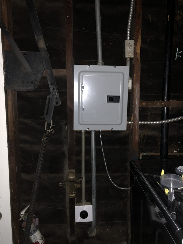

Join Date: Aug 2018
Posts: 6
Received 0 Upvotes
Does this look good now? Upgraded breaker to 30 amp, installed ground bar.
Do I need to pigtail the metal box, or is it already grounded back to the panel since it's running through the metal conduit?
Just because it bugs me to look in a messy panel I would make the left side wires look like the right side. I like the nice square look.Don't look in my main panel tho. It is a mess.
Not electrician so can't tell for sure but looks ok to me. Ground should be through medal conduit;
I didn't know that receptacle was right below the breaker panel. You did not have to run 10/3 NM, but doesn't hurt to do so since it is straight down.
Move green wire from MC cable in the middle to the ground bus bar.
Would have been able to make it look cleaner if you pulled the cable a little longer, but it is ok.
