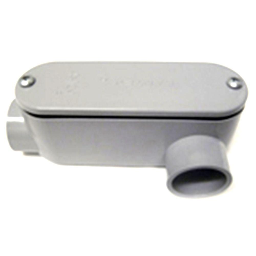

Using Xsleeper as an inspiration, what about running 1" solid conduit up through the roof jack connecting a LL Conduit Body
where it exits the roof jack and then connecting the liquid tite flex line to it (somehow?) ?

A PVC LL or LB is not 100% watertight.
I've always used SealTite for an installation like that.
I've seen a lot of similar fittings outside buildings, is it because they are metal?
Is there a way to transition from the solid pvc to the sealtite (exterior box)? I'm leery of running sealtite down through the roof jack due to it's flexing and curvature.
Or could I run a long sweep as it exits the roof jack and then connect to the sealtite?
