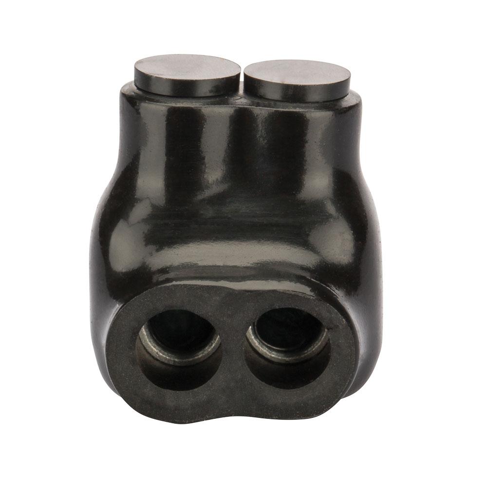

Your splices should use either the big blue wirenuts or a split bolt (electrical taped to insulate). More ideal but more expensive is a product called a Polaris that is already insulated.
Split Bolt
Polaris

I was thinking of using a 12x12in box (https://www.homedepot.com/p/12-in-x-...3713/202043349) since the larger guage wires are a pain and I figure there should be a little bit of a service loop in the box. The polaris connectors are nice, if expensive, but perfect for a simple job like this.
Thanks for the additional info!

Polaris are nice connectors but the large blue or grey wirenuts are fine for 2 #6s and cost less.
