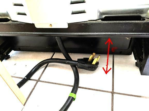

For a while I have been dealing with a range/oven that cannot be pushed all the way against the wall, it can go as far as 3" off the wall and that's it.
The reason for this is the original rough in of the range receptacle back in the 1960s was too high for the range.
The back of the range, as shown in the picture below, has a recess area for the socket and plug but it's not high enough. So the plug is about 1.5" higher than it needs to be.
