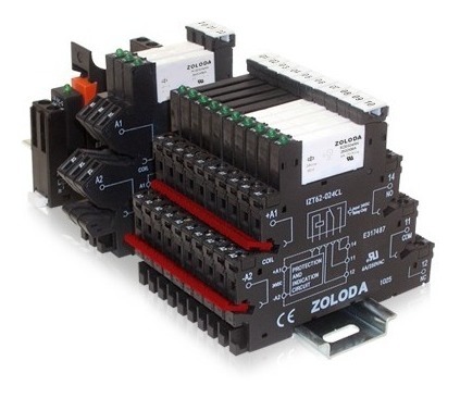

If you want individual indicator lights then you need individual wires from each switch. If you want one buzzer for all of then then you want a 2 contact relay for each one. One contact turns on the light and the second contact turns on the buzzer.

So Joed's mention of relay's made me think, Is there any way I could get away with one or two? They have 4PDT relays that aren't that big but I'm not sure how I could use the 4 poles to help.
Having 5 relays seemed originally like it would take up more space than I had but last night I was browsing online catalogs and came across some low profile SPST relays like this
And that got me thinking, what if each warning light circuit turned on one of the relays which the connected the alarm? That might work right?

just a quick stab at this: all the NO overflow switches can be connected in parallel; ending with only a single pair. More difficult may be the overloads/heaters. Although i recall there is a uncommitted contact from each, it won't detect an overload from simply being turned off. I suspect this job would require an additional relay for each, powered by the coils, then feeding thru the existing aux contacts.
