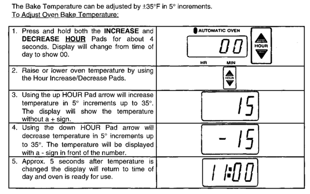

Hmm, I'm wondering if I was to follow the "adjust oven bake temperature" instructions seen on on the page in the manual provided by Pete (screenshot below) whether that could remedy the problem I described in post #10 here. I'm really not clear on whether I'd want to increase or decrease the temperature, based on what I explained in that post, or whether that would have any effect at all toward remedying the issue.
Old 11-27-19, 11:20 AM
PJmax's Avatar
Join Date: Oct 2012
Location: Northern NJ - USA
Posts: 60,786
Received 1,324 Votes on 1,224 Posts
That temperature adjustment is only for fine tuning. It's usually only a 10-15 degree maximum shift.
