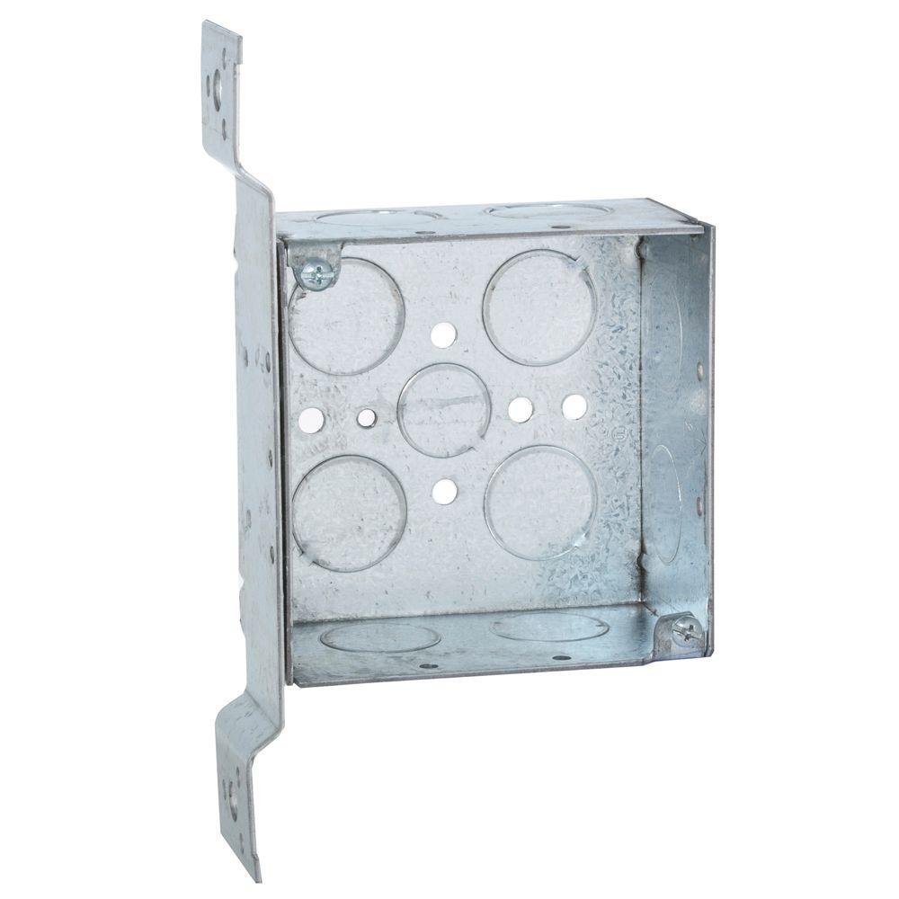

First time I've used a mud ring as opposed to a standard gang box.
usually you screw the receptacle into the box but how do you work with the mud ring?
You attach the ring to the 4" box then screw through the mud ring to attach the receptacle but from the inside?

Maybe you should stop thinking and listen to Joed. There are 2 types of 2 gang mud rings. Single and double device.

You are not installing the mud ring properly.
The box goes on the stud.
The mud ring goes on the box.
The drywall goes on and covers the mud ring except the raised portion device hole.
The device goes onto the mud ring as if it was any other box.
If the mud ring is sticking out too far then you mounted the box too close to the front. The front of the mud ring should be flush with the wall finish surface.

The word mud ring means the wall gets mudded around the ring so as to be flush with the wall. If it sticks out its because you put the box too far out.
The mud ring you have pictured is too large for that box.
You'd use some type of square box (there are different options based on what you're attaching it to). It gets attached to the stud at the edge of the stud (even with the stud):
The mud ring then gets screwed into those two screws in the corner.
Then the drywall is installed, leaving just the rectangular section open, the drywall covers the flat metal portion of the mud ring.
Lastly, the device gets installed like any other box. Leave the ears on the device, and screw it into the upper/bottom tapped screw holes.
You have a double-gang mud ring. There's no issue that the devices are close together, once they are mounted, there will be the standard 1/2" or so between them.

The perspective on the picture is not great.
the mud ring has space for 2 devices but it doesn't separate the devices like a plastic cover.
Shouldn't there be a metal strip running vertically to stop 2 duplex receptacles from touching each other?
Edit: oh I see, you're saying I should have another cover plate to go over the mud ring? I thought the ring was the cover.
I'm trying to find a flat metal plate as the cover for use in a basement with power tools so don't want a plastic cover as it will likely break with no wall behind it... Wanted a metal plate that isn't wider than the box

Not instead... you need that also.
yes. The piece with the divider is the cover.
A mud ring is used when drywall or some other finish material is installed. The mud ring should close to flush with the finished surface of the wall for the devices to be installed.
The industrial cover is used when there is no finished material on the wall, or the box is surface mounted.
As mentioned, the mudring you have is for a 4 11/16" x 4 11/16" box (aka 11b) not a 4" x 4" box.
