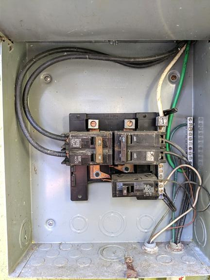

The meter is on the outside wall of the garage, and next to the meter are two panels which I labeled "A" and "B".
Panel A - has the main breakers to turn off EVERYTHING in the house. It is labeled "MAIN 1 OF 2" with a Sharpie. It controls the wiring in the two original bedrooms and bathrooms, as well as the downstairs central AC handler and compressor.
Panel B - controls the outside wiring, the pool pump, spa heater, pool lights, outside motion lights, pond pump, post lights, front gate motor.
Then inside the garage I have another panel, which I have labeled "C".
Panel C - controls the kitchen, garage, living room, dining room, second floor addition.
I am thinking panel A is the first and original panel? Then panel B was added and then the panel C inside? So panel A is the "main" panel and B & C are subpanels?
As I try to determine which breaker controls what, I need to label each of them so I know what breaker controls a particular receptacle or switch...I make a notation on the back side of the cover plate that this is circuit 8A, this is circuits 5B/7A etc, but with three panels I need to reference which panel. Is there a customary convention to follow for labeling the panel+circuit? Is it something like A,B,C or I,II,III or something else?

Panel A looks to be the main panel.
Panel B is fed from Panel A.
It looks like panel C (which is a sub panel) is powered from Panel A.
Beautiful picture of panel C. Panel A needs a closeup pic too.

Here are closer pictures of Panel A.
What would be a good way to label at the fixture end which panel it comes from on top of what circuit they are on?

Those two splices (greenish) are the tap/supply to panel B. So panel B is protected by the breaker on the left of that panel.
Label them with panel and circuit.
C-1,3 (240v)
C-2,4 (240v)
A-1
A-2
etc..
Are you sure? I only see one 2-pole breaker and one 1-pole breaker for branch circuits. Is there another subpanel fed by Panel B. The only other breaker I see in Panel B appears to be a backfed 2-pole main breaker.
You are correct I had messed up there. The pool pump were powered from Panel A. Panel B is only for the DP 60A spa heater and another 20A which does all the outside motion lights, pole lights, some landscape lights and a small pond pump etc...
Is Panel B even necessary? Can these be added to Panel A somehow?

Panel A looks full. I don't see any empty slots. That is probably why they added panel B.
