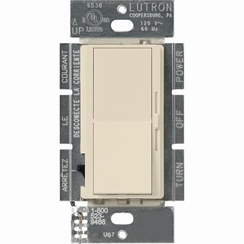

The newer 1000w dimmers still have fins/tabs, but don't require nearly as much heatsink.
https://www.homedepot.com/p/Lutron-S...R-WH/202791249

I am thinking of going with the Lutron DIVA DV-10P dimmer switch for the middle set of lights.
It is rated for 1000W as well but it does not have the thick protruding fins. It has some fins on the sides, but since it is going in the middle of the 3 gang box I will have to remove the fins on each side. The specifications stated that for a 3 gang box it will be derated from 1000W to 650W, I assume that means with the two sides removed?
I have in the middle the 7 lights 60W max each so it's 420W under the 650W, on top of that I will be using LED bulbs which use only 5W each. That should work right?

You're correct, removing the fins to fit in a 2-gang or 3-gang box does derate the dimmer. But (I just learned something new), if using LED or CFL bulbs, there is no derating!
Regardless, since you'll only be using 5w bulbs anyway, it hardly matters. Keep the fins you can, but you can remove the ones needed to gang them.
Lutron derating guide
