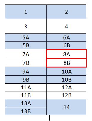

Moved into a new house and tracing and documenting the panel and breakers I see something that looks wrong.
Inside the panel I see a 12-3 NMb wire with the black conductor connected to one breaker and the red conductor connected to another breaker directly below it. The wire runs somewhere to a bedroom, one breaker controls the lights the other breaker controls the receptacles. They share the same neutral conductor. This is a MWBC correct?
This is a GE panel and some of the breakers are the half size skinny breakers. So the 12-3 is attached to circuits 8A and 8B, my understanding is that with MWBC you need to be on opposite legs, and on the panel circuits 2, 6, 10 are on opposite legs of circuits 4, 8, 12 right? So 8A and 8B would be on the same leg? I need to rearrange them so they are on something like 6B 8A or 8B 10A?
There is no handle tie either.

Correct. You need to be on opposite legs of the service.
8A and 8B would be on the same leg.

That won't work. The breakers need to be beside each other so the handles can be tied together so they go off together. You would need something like 7 and 8 or 8 and 9. If you want to use half size beakers then you need a quad breaker with the two inside and the two outside tied.

joed, thank you. However I am trying to understand why it won't work. This is what I have right now.
Just to make sure, I showed them in blue and white to indicate different legs of the service, and I also showed the breakers in different thicknesses as I have a mix of regular and skinny ones.
The current MWBC breakers are in 8A and 8B, clearly on the same leg as you have confirmed.
Why can't I swap the 8A and 10A skinny breakers, to have them result in opposite legs, and add handle ties?

Because the fins behind the breakers might not be arranged, polarity-wise, as expected, it is necessary to use a voltmeter to be sure that 240 volts is measured across the two breaker terminals to which the MWBC conductors will be connected.
Thanks, I will confirm with a voltmeter to make sure they are on the same leg first.

Do the 8A and 8B (and the 10A and 10B) skinny breakers come apart and snap out individually?
You could leave the breakers in place and swap the wires of 8A and 10A if needed provided that the breaker ratings match and you are not messing up the polarity for another multiwire branch circuit.

Those skinny GE DP breakers are designed to fit only when they hit both phases and only work in GE panels. The rejection tabs are set up to work that way.

My mistake on the breaker number system. You are correct. But a single tandem won't install across 6b-8a. You would need the quad version.
Those are not DP breakers, those are a pair of single skinny breakers, not a problem relocating them. I just need to tie the handles together.
