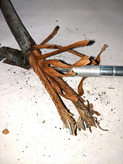

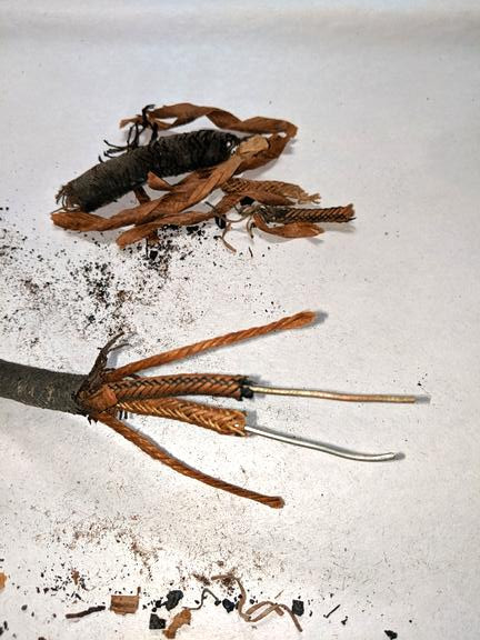

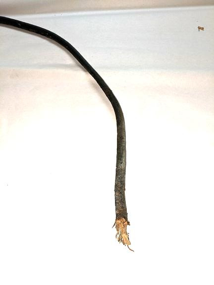

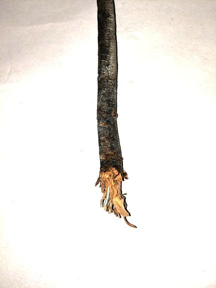

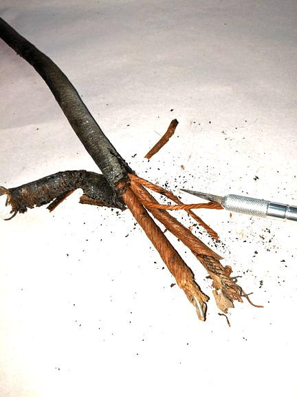

I was able to remove two pieces of this wiring completely between two wall receptacle boxes about 4' apart horizontally. I know the part of the wiring inside the box is bad, brittle, crumbling, from all the twisting, folding, pulling and pushing over the years, but I wanted to have a look at the part of the wiring outside of the box to see if they are in the same bad shape or if they may still have some life left. In other words, if the wires outside of the boxes are as bad, then there is no fixing anything except to replace all, but if they are in much better shape then my option of either loosening the clamps inside the box to pull in more slack or to use heat shrink tubing on the crumbled ends may work to buy me some time.
Here are some pictures of this piece of wire. I already cut off the crumbled portion inside the box. The outside black colored sheathing seems to be OK, It survived the hard pull through the stud holes, but if I were bend it back and forth at a 90 degrees like 5 to 6 times it will break the sheathing.
I used a razor blade to cut open the sheathing, inside are two conductors wrapped in paper. This paper coiled around on the outside and it's brittle.
If I then tear the paper away I then see the cloth insulation. That seems to be in pretty good shape actually.
If I cut away the cloth insulation, there is some black brittle plastic coating on the conductor but they broke off easy too.
Thoughts? Do I have time to plan out the rewire in phases or is this a "the house would be on fire tomorrow" situation?

Prior to 1980..... there could have been asbestos used in the cloth covering.
I don't see much of a problem handling the wire. It's the dust that is harmful.
It probably wouldn't hurt to wear a mask when working with it.
As far as cloth covered wiring..... I have not seen it as the direct cause of fires.
Usually as long as it's not disturbed it's integrity is ok.
That's not to say it's completely safe. I recommend to customers to have it replaced as soon as possible.

There is an overall cloth covering.
Then each wire has a cloth covering over rubber insulation.
The cloth covering has the white and black coloring. The rubber inside is only black.

If there were asbestos it would be in the cloth covering.
Either the overall outer jacket or the individual jackets.

If those are tin plated copper conductors, I am surprised the tin has not turned dark. Have u scraped enough to see bright copper?
i suppose it is likely those could be solder (tin/lead) coated.
