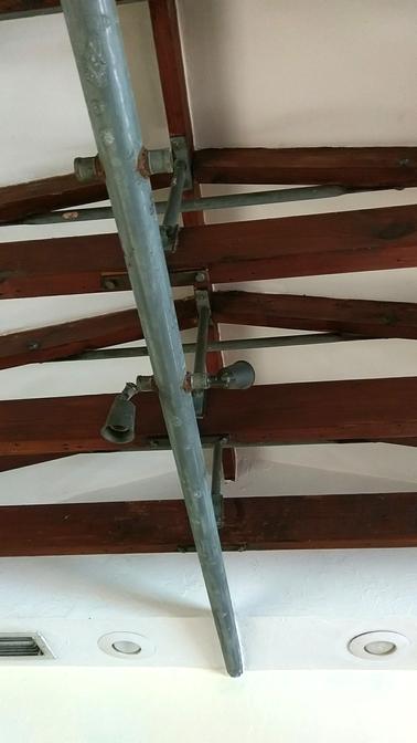

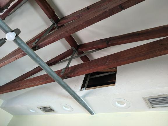

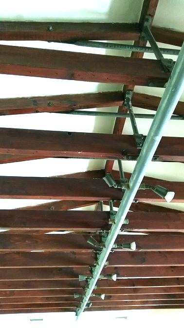

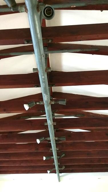

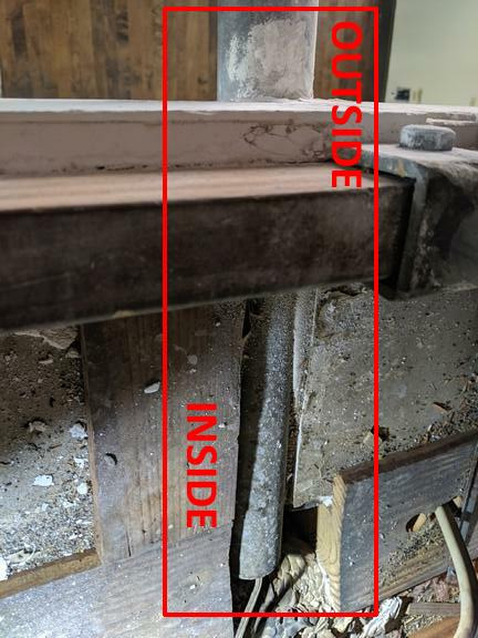

I have what I believe to be a custom conduit light fixture and I am trying to decide what I should/could do.
There are a total of 20 female connectors welded along this conduit. 10 of them unused and left open. The other 10 are wired with those standard lamp holder fixtures that you will find in exterior flood light fixtures. All of them work except for 2 and all controlled by the same switch. I have five 6w LED bulbs on them right now.

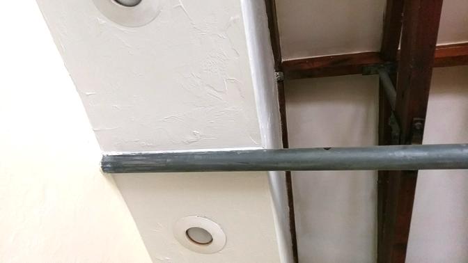

At the end of the conduit it disappeared into the soffit/ceiling.

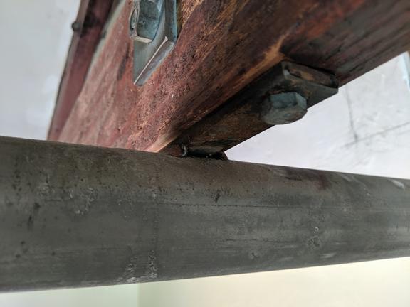

The conduit is about 3" in OD. I think the entire conduit is considered a junction box. It has a plate welded on the top side to connect to the bottom of every joist.

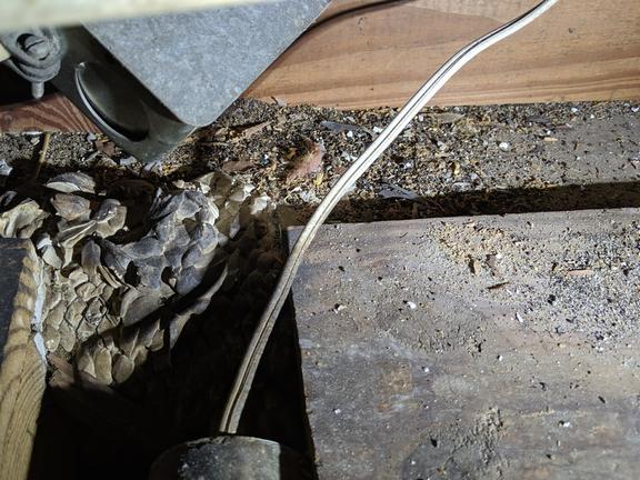

The past weekend I cut a hole on the wall of the soffit in order to get do some wiring modifications - change out some old 2 wire cloth romex wires to NMb wires.
But once I looked into the opening, I was able to see the end of this conduit. It is open ended, not tied to any junction box.
and what goes inside the conduit looks to be a thin lamp cord?
Is this a problem?
The conduit light was made to match the framing steel members obviously. The connecting plates to each joist had to be welded on, the laborious effort to fish the wire to each hole, this wasn't some DIY weekend warrior project 80 years ago.
If I decide to keep this fixture, do I need to rewire it? Do I need to connect the open end to a box? I assume the other end is the same.

Your fixture is not listed by any testing agency as required.. I don't see where the junction was made to the home's wiring.

It is a bit of a grey area. The entire assy could be considered a light fixture. In that case the lamp cord within it is fine. However the lamp cord should terminate in a normal junction box to regular household wiring.

It is definitely a "custom" installation. Obviously not UL approved and doesn't really fall under the NEC since it's a fixture (in my opinion). I don't see any reason to worry too much about it - it's obviously been working for decades.
- I don't like the small lamp cord running probably 600-1000w when it was incandescent, but now with low-wattage LEDs, I don't see any issue.
- I would somehow add a ground wire to the metal pipe. This will help protect if a splice in the pipe gets loose, and there are probably a lot of splices.
I'm trying to figure out how to mount a standard electrical box to the end of the pipe and ground it. Maybe if a 3" EMT connector would fit, it could then go into a plastic 4x4 or 6x6 box. It would also provide you a threaded mount to the box and the ability to ground the pipe using a ground bushing.
Basically you don't want the lamp cord just hanging in the air like that.

Yes I know this is non-conforming to any code today.
I have junction boxes near by, and I will trace where the lamp code goes to. My guess is it goes to a junction box in the attic, because it's regular romex at the wall switch.
Is it a fire hazard? Presently I am using five 6w LED bulbs, that's 30W total. I cannot imagine back in the days if someone connected all 10 with 75W bulbs, that would melt a dimmer even rated for 600W right?
Once I find the lamp cord's other end, should I replace it from there to where the conduit ends with say a 12-2 romex? and put a junction box as close to the end of the conduit as possible?
Yes it might help to ground the pipe. I can tape a hole on the pipe to attach a ground screw.
Wait, what if I use a step bit to drill a 1/2" KO hole on the top side of the pipe? Debur the edge to make it real smooth. then put a close nipple in, secure on the inside, then mount a 4x4 metal box on it, then thread the lamp cord through the KO hole to the inside? Then splice to romex, cover with a blank cover plate. Would that work?

Yes they are welded to the pipe. Total 20 couplings, 10 on each side. But 10 if them are not connected to anything just empty connectors I can see straight through to the opposite side's coupling.
There are twelve joists, so twelve steel plates also welded to the pipe where it is attached to the joists.

I traced the wire coming out of the conduit to a junction box about 4' away. There it is spliced to a 12-2 romex cable.
So one question is if I add a new junction box at the pipe, and run the thin cord to that junction box, then replace the 4' of wire in the attic with regular romex to the existing junction box, that should help some right? No way it will ever be legal conforming but while I have the soffit open I like to do what I can.
