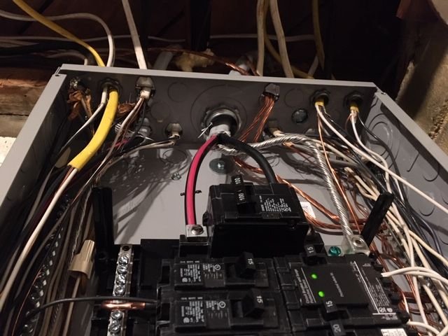

Hello DIYers,
In previous posts I have asked and received great feedback regarding my plan to feed power from my house to a new garage that is going to be built. I would really appreciate the knowledgeable individuals review of the methods and materials I intend to use to perform this project. Any constructive thoughts by readers of this material would be welcome.
The panelboard in garage will be fed from 60-amp breaker in existing service panel and it will be rated at 100-amp (100-amp breaker will be used as disconnect in garage). I am providing photos of the service panel that the feeder cable will be exiting. A junction box will be mounted on the home's exterior brick wall and located basically right behind the service panel.

- Use 6/3 (with ground) NM-B wire exiting from the top of service panel and feed thru hole to be drilled in home's brick exterior.
- 6/3 NM-B cable will enter into 6" x 6" x 4" PVC NEMA 4X enclosure thru a hole I will drill in back of enclosure that is mounted on the home's brick exterior
- Will use Polaris Insul-Tap connectors to splice wires of the 6/3 NM-B cable to #6 THHN/THWN wire, and also splice #10 bare ground from the NM-B cable to a green #10 THHN/THWN wire.
- Will run the #6 THHN/THWN wires, and the #10 THHN/THWN ground wire, into 1" PVC fed from hole drilled into bottom of NEMA 4X enclosure
- 1" PVC will be buried so top of PVC is 18" below grade and will be fed to 90-degree PVC sweep fed into garage thru its rat wall
- Will use Ufer method for ground electrode (plan on using 20 feet of #2 bare stranded conductor as grounding electrode)

Should I decide to go with the idea of mounting a box to the exterior brick wall, is it acceptable to use NM-B to feed from the service panel, thru the wall, and then into the exterior-mounted box? The NEC seems to be a bit unclear about running NM-B cable through brick walls and what is considered a wet/damp location. Please know that I do intend to pull an electrical permit for this project.

One other question. I need to go about 40 feet with the PVC as it travels from my house to the new garage, and this will require a bend in the PVC run at about the midway point between the house and the garage. Being that I am running a quantity of (3) #6 THHN wires, as well as a #10 THHN ground, do you think it will be okay using a 90-degree sweep for the bend or would it be necessary to bend the actual PVC in not so acute an angle? Thank you.

Correct: The subpanel does not need ground rod connection.
Correct: The subpanel must not have ground and neutral interconnected (bonded), grounding accomplished by the ground wire (equipment grounding conductor) in the feed back to the supra panel.
Experts do disagree about ground rods in different locations about the house. But they all do agree that all the various ground rods need to be interconnected using #6 copper wire
Right now we are assuming that this is for a DETACHED garage. As such it will need a GEC so the UFER mentioned will suffice with no ground rods needed. If garage is attached to the house then ufer is not to be used.
Agreed Astuff, and yes, this is a detached garage. The wires leaving my home's main service panel are considered part of a feeder and not a branch circuit, hence the need for a separate grounding electrode/ conductor. Branch Circuit is defined in Chapter 1 of the NEC book as, "The circuit conductors between the final overcurrent device protecting the circuit and the outlet(s)".
In this case the "...final overcurrent device protecting the circuit" would be in the panelboard that is located in the detached garage. The wires from the my home's main service panel feeding the panelboard in the detached garage are going to a 100-amp main breaker in the garage's panelboard, and this main breaker will serve as a disconnect means for the panelboard in the garage. Since there are individual breakers inside the garage's panel board, and they are what the garage's circuit conductors are connected to, these breakers are considered "...the final overcurrent device protecting the circuit and the outlet(s)".
Since you are reviewing all details... Another limitation is that copper NM-B is only rated at 55 amps. Going to a 60 amp breaker is fine but only if the calculated load is 55 amperes or less.

Thank you for calling the amperage issue out with respect to 6/3 NM-B. The calculated load would be no more than 55 amps, but I will let my AHJ know about my intention of using of 6/3 NM-B as a feeder from the service panel to the junction box.

I just want to thank all of those who provided advice to me as I asked questions related to running electrical power to my detached garage. I passed both the rough and final electrical inspections without a hitch. Again, thank you to all who shared their electrical knowledge with me.
