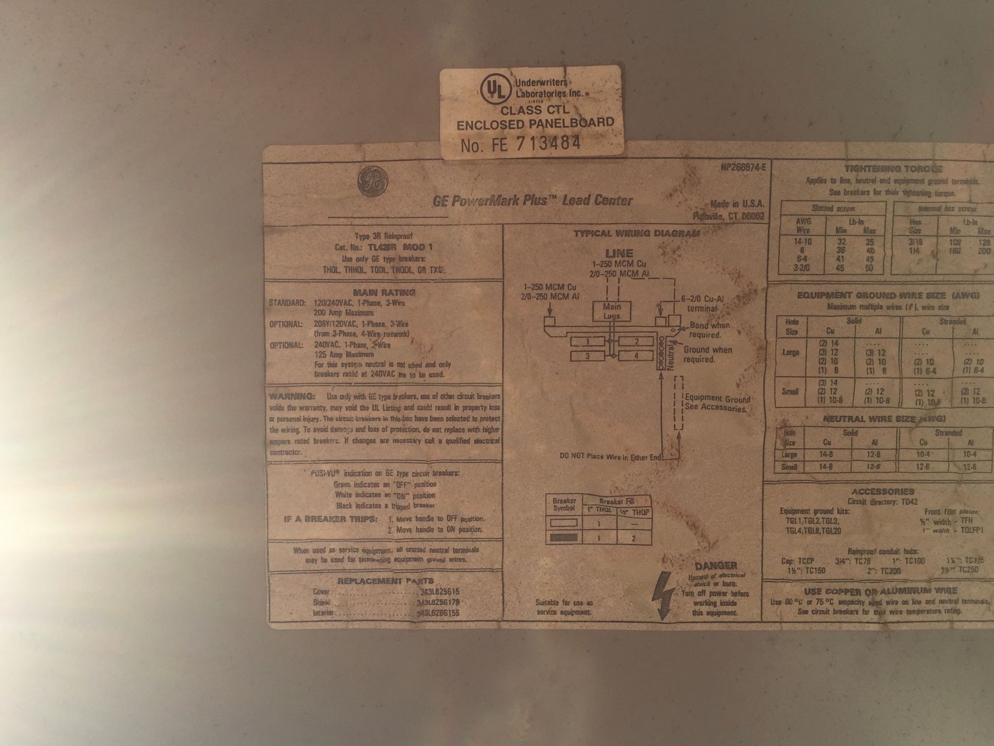

i am wanting to run a new breaker from my main box so i can power my shed and when i open it up, there is no "tabs" to attach the breaker to. I have no idea what these things are called to search for them to buy. im including a generic picture with the "tabs" circled and a picture showing my box. I will also include all the information i have on my box type.
main box ( with one breaker removed to show inside. )
Note: I am aware that my main box is live and will not attempt anything without having the electric company cut the power.

That's a main disconnect panel with only 4 spaces. There should be another load center.

We can see the lower main disconnect panel is designed to hold two 2Pole breakers.
We can see the 100A on right that probably feeds a sub panel.
You said the breaker on the left was removed to show the bus bars.
Is the breaker on the left connected/used for something ?
For you add another circuit there..... you'd need to replace that disconnect panel with a larger one.

The 100A is on a sub panel to the house. The left breaker is a 50A that has a sub panel to the garage. We are trying to run a 70A breaker down to a shed on another sub panel to run welding equipment. I guess there is no way around it and i will just have to spend some extra money haha. thank you.

Yes, but not too much. Just replace the 4 space panel with a 6 or 8 space panel and you are good to go. By the way, your existing disconnect panel is a GE and it has a 100 amp Murray breaker in it. From this point forward, try to do things correctly.

This is a NEMA 3R raintight panel and when considering the OP's statement
we will find that this raintight panel is the main panel with main disconnects and is located under the meter.
I still don't see any huge issue here.
