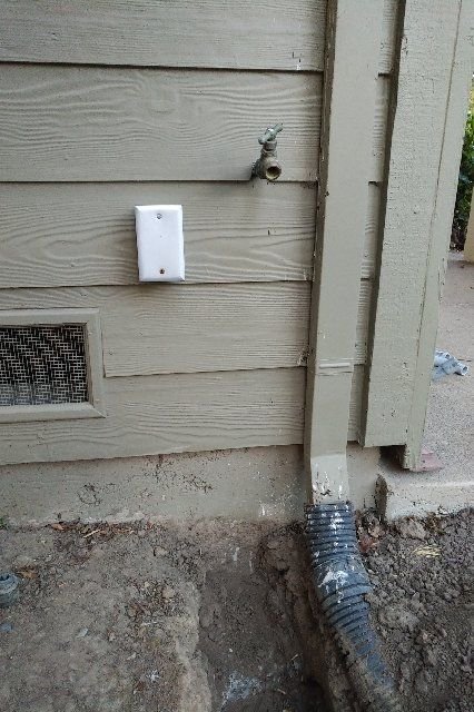

Another question. I trenched the conduit run originally thinking I would use PVC all the way up the wall. I will use EMT. Attached is a photo of my trench and side wall. I would like to run the EMT conduit
alongside the downspout to hide it a bit. A junction box is the ideal transition, but I would have to mount it above the hose bibb. The electrical box in the photo is an unused landscape lighting stub. Is it code or acceptable practice to run PVC threaded adapter to a water-tight EMT fitting like a Myers hub (it may get messy getting the M/F right) to the EMT?

I will run EMT along the wall. I don't think i can get conduit inside the wall.That wall is on the southwest corner, facing west, so it gets afternoon sun.
How would you transition from PVC underground to EMT?

Hi Pete, Yea, that's my understanding and i am trying to sort that out. It is a kit using Enphase micro-inverters so the inverters are on the array instead of DC to the garage. The company that sold the kit said the Enphase micro-inverters automatically shut down when they lose connection with the grid. It is all AC wiring and there is a breaker in the Enphase combiner at the array (it is a ground-mount), plus the breaker in the main panel. The country permit office approved it with no disconnect switch on the SLD. The PE who did the SLD said he is not sure what the county or the POCO require...which doesn't inspire confidence.
A NEMA3 disconnect switch could serve as the transition between PVC and EMT, mounted above the hose bibb. I am a little nervous about anal inspectors because the approved plans are stamped saying any contractor deviations must be approved in writing by the county or it will be rejected. The county has a reputation for being a real pain to work with. I have trouble believing an inspector would reject a disco switch but then again, it's not on the approved SLD
What do you think?
What do you think?
Hi, Was this system designed by Enphase and signed off by the county the I don’t think you should deviate from that, the system is protected at the array , one question I have is what kind of equipment is connected at the other end of these cables , is it at your service entrance?
