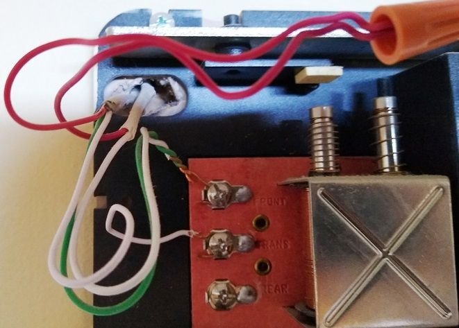

17 year old house. I have two doorbell chimes wired in series. I want to remove the first chime in the series, but continue to use the second chime. At the chime to be removed, I'm thinking I keep the red wires connected, cap the other other wires, shove all back into the wall and patch over them. Is this correct and safe? Thanks.

We would need to see a picture of the wiring. There needs to be at least two wires carrying thru.
How-to-insert-pictures.
Consider carefully burying the wires in the wall as they will be lost forever.

Wiring pic
Hopefully this link will give you the pic. Green and white to "Front" terminal. White to "Tran" terminal. Two red tied together.

Keep the red wires connected together.
Redo the green/white splice and cap off.
Cap off the single white wire.
In the picture the green and white splice is poor.

OK, but my plan is to remove this chime anyway and keep the one downstream in service. Can I disconnect the green and white wires, cap them, keep the reds connected, and shove all into the wall?

You can remove all the wires from the chime but the green and white wires must remain connected and capped. The single white wire gets capped by itself.

Gotcha. Safe to put in the wall, right?

Yes...... safe to put in the wall.

I would not seal the wire ends in the wall unless they were soldered -- the red-red pair and the green-white pair -- and taped so the splices cannot touch.
Otherwise oxidation might cause a loose connection decades from now and the next homeowner will have problems.
