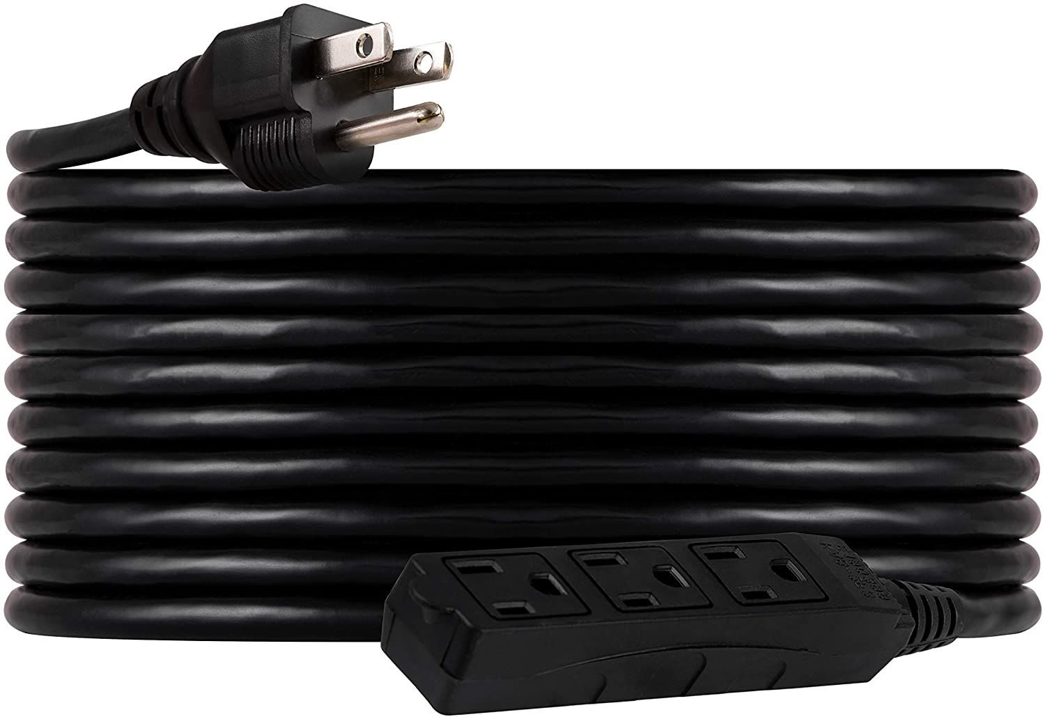

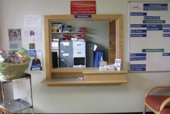

To explain the picture more I was thinking that I could make a large opening in the wall near the floor. The opening would be about 12 by 12 and be finished like in the picture below; And then I would run regular extension cords through it. The below image is just an example of a large opening that is finished. I was thinking about doing the same thing but making it around 12 by 12 and closer to the ground.
This might enable me to run regular extension cords to the other side of the wall like shown below:
However, is it code compliant?

I think the plan using extension boxes and EMT or Wiremold is a good solution.
Extension cords are only allowed for temporary use, and many areas don't allow them at all because they aren't protected (whereas power strips have built-in circuit breakers). There's also the issue with running them through the wall, which isn't allowed.

Ok... I appreciate it. I wasn't sure what it would be for code. Sense I was making a big hole and finishing it I wasn't sure if that qualified or not for going through the wall.
