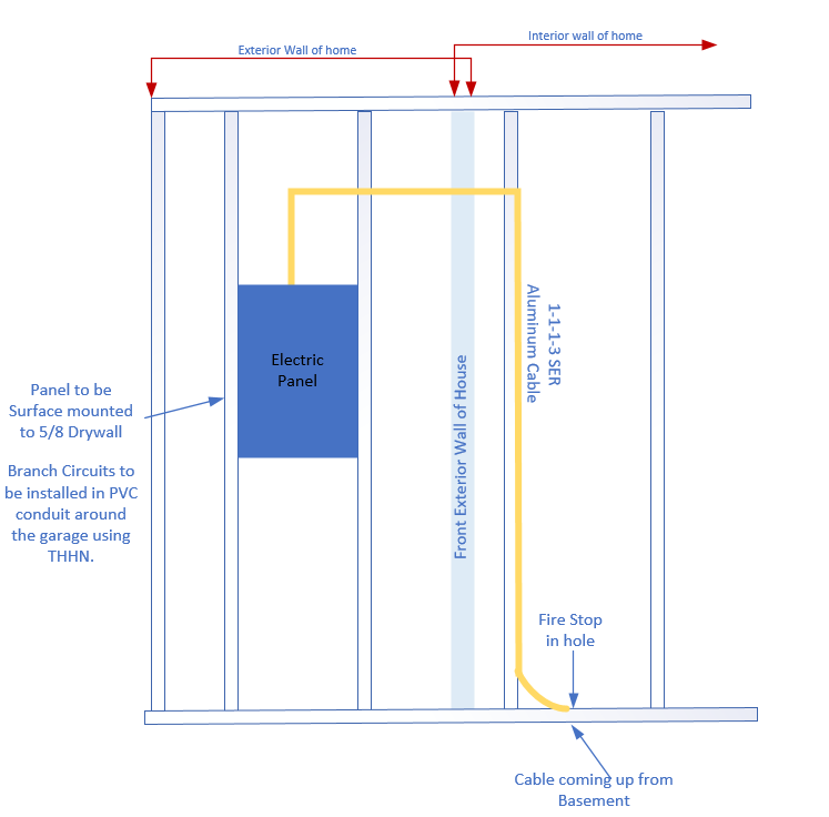

Can someone tell me if what I am doing in this diagram is acceptable? Curious if the transition from this being and interior to exterior wall has any bearing on anything.
Also I would very much like to put some protection behind this cable to prevent nails/screws from getting driven into it from the inside. I have read there is some kind of metal shield/blocking that I can place behind the cable to prevent this. Can someone confirm that and tell me what the name of the product is so I can find it?
Once again many thanks.

Advice on Routing Wire and Conduit
I am attempting to install a new sub panel in my attached garage. Could someone take a look at the picture below and give me some advice on how to make sure I do this to code.
My plan is to use some 1-1-1-3 SER Aluminum cable to come thru my basement and pop out into the garage. The attached picture shows in red where the cable would come up from the basement and where it changes to blue is where I would begin with the conduit. I plan on surface mounting the new panel on top of new 5/8 drywall and will put some backer board behind it to offer the box proper support.
Anyone see issue with this? What is the correct way to come out of the wall and into conduit?
Thanks in advance

Threads combined. You deviated from your original plans but this is still your thread so you change anything you want. We try to keep like topics in one thread to eliminate duplicate questions.
You can use what is called an LB to bring the wire out. Keep in mind..... it is extremely difficult to pull this cable in conduit. It doesn't bend easily.

I would just sleeve the cable in a conduit to the panel. Is there a reason you don't want the panel close to where it exits the basement?

The panel needs to be placed where you can stand in front of it with no obstruction 36in of the front by 30in wide. Is that a built in bench in the picture at the panel location?

The bench is actually why it needs to go toward the front. The bench in the picture is slid out of the way but when its reinstalled it will block it if I don't move the panel to where I have it on the drawing.

Ok... Due to other non-electrical related factors I have decided to just mount the panel directly over where the cable comes up out of the basement and throw away the workbench and make a new one. That reduces my level of complexity pretty significantly. With that in mind my last question (I hope) is can I just go directly into the back of the new panel with the cable or do I need to pop out of the wall into an LB and use a short stub of conduit into the box?

I'd just jog the cable out of the wall and come in the bottom of the panel and use a NM clamp to secure the SER cable to the panel. Then make a wood chase to cover the short section of exposed SER. You can come in the back if you have a lower corner back knockout but you may find it hard to bend the cable to manage it through the hole.
