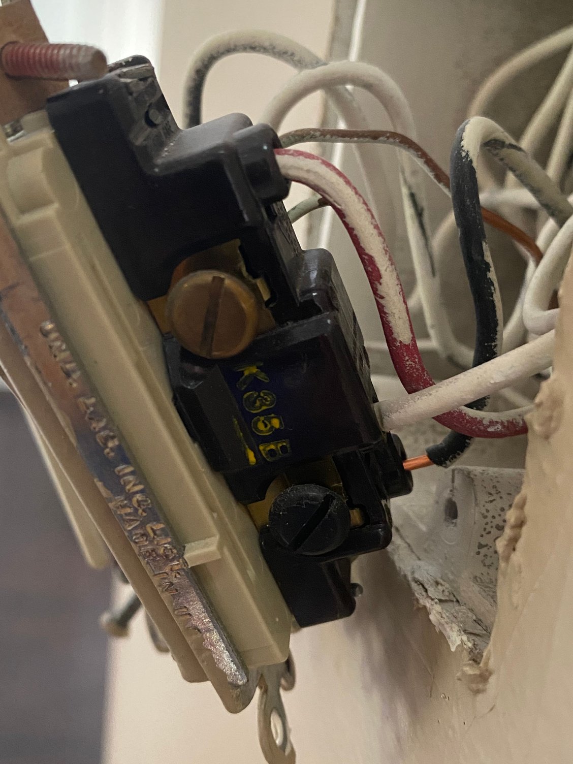

I am replacing the switches in my house, and I'm confused about one of the 3-ways. I'm trying to understand how it's configured. The switches control two light fixtures. When I look in the first box, I see the following. There is a 14/3 coming into the box. Red traveler at the top, white traveler in the middle, and black connected to bottom common. As an aside, I noticed that the back push-in connection has failed, and the wire is pulling out.
In the other box, I see the following. The top wire is the 14/3 black. The middle wire is the black from a separate 14/2 that comes into the box, and the bottom common is the red wire from the 14/3. The red wire is marked as hot with black tape.
If anyone can help me understand this, I would really appreciate it. If you need more pictures or clarification, just let me know.

Here's the important thing..... it doesn't matter where the screws are on a 3w switch. Two screw terminals are identical and usually brass colored. One screw is always darker or black. That's the common screw. Whatever wire comes off the dark screw must go back on the new switch dark screw. The other two can be connected in either location.
We also recommend not using the push-in terminals on switches or receptacles.
It's just a future problem waiting to happen.

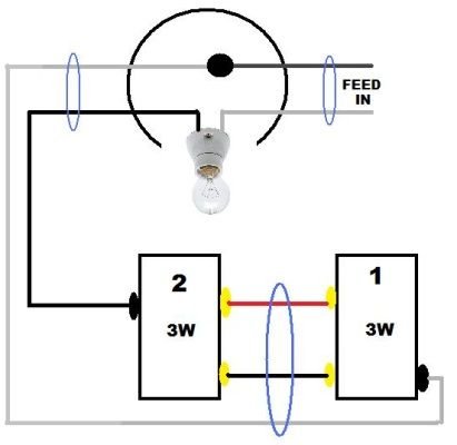

Let me explain what you have......
You have the power coming into your light. Then from the light a two wire switch loop controls the light. So at box two..... the white wire is hot from the light fixture and the black wire is the returning switched hot wire. You don't have an available neutral on that circuit.

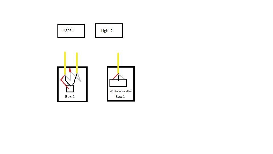

Thanks, PJ. I feel like I'm missing something in my understanding. This is how I currently see the configuration, but I'm not sure how light 1 and light 2 come into this. Like you said, I believe the power is being run to one of these lights. I am confused how the white wire on the 14/3 is line voltage. Is there any way to make the insteon switches work. I know they sell one that doesn't require neutrals, but I always try to avoid them. As an aside, there is a switched outlet in Box 1 (separate circuit). Does that help at all? I know that technically one of the switches only needs power and neutral. I could technically put one of the switches on a separate circuit, but I don't know if it's doable in this situation. I didn't mention that in my original posts, because I didn't want to complicate anything.

You switch drawing aligns exactly to what pjmax has drawn.

You have two lights. One was probably the original and contains the power in, switch loop and switched feed to the second light.
Here's the problem..... by code you are not allowed to use the hot from one circuit and the neutral from another.
If that receptacle in the switchbox is on the same circuit as those lights.... you can then get your neutral from the receptacle. Try turning the breaker off for the lights and see if the receptacle is dead.

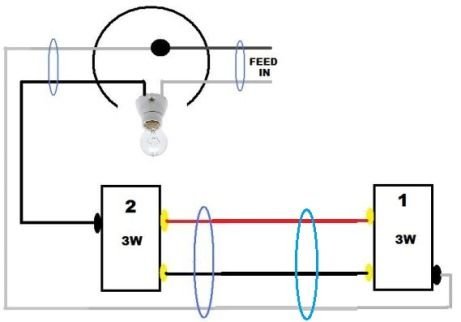

First picture in post 1 is a dead end three way switch.
Black is common and red and white are travelers.
Look at the diagram. Switch 1 is the dead end switch. What that means is that the three wire between switches ends at switch 1. All three wires in the three wire cable are connected directly to the switch. Hence dead end.
The wire on the dark screw is common. You connect that common to either traveler wire. The unused traveler wire gets capped off.
Look in the switch 2 box. You will see a three wire cable that goes to switch 1. Two of the wires in that three wire cable are used as travelers. You can abandon that three wire cable in box 2 and do absolutely nothing at box 1.
