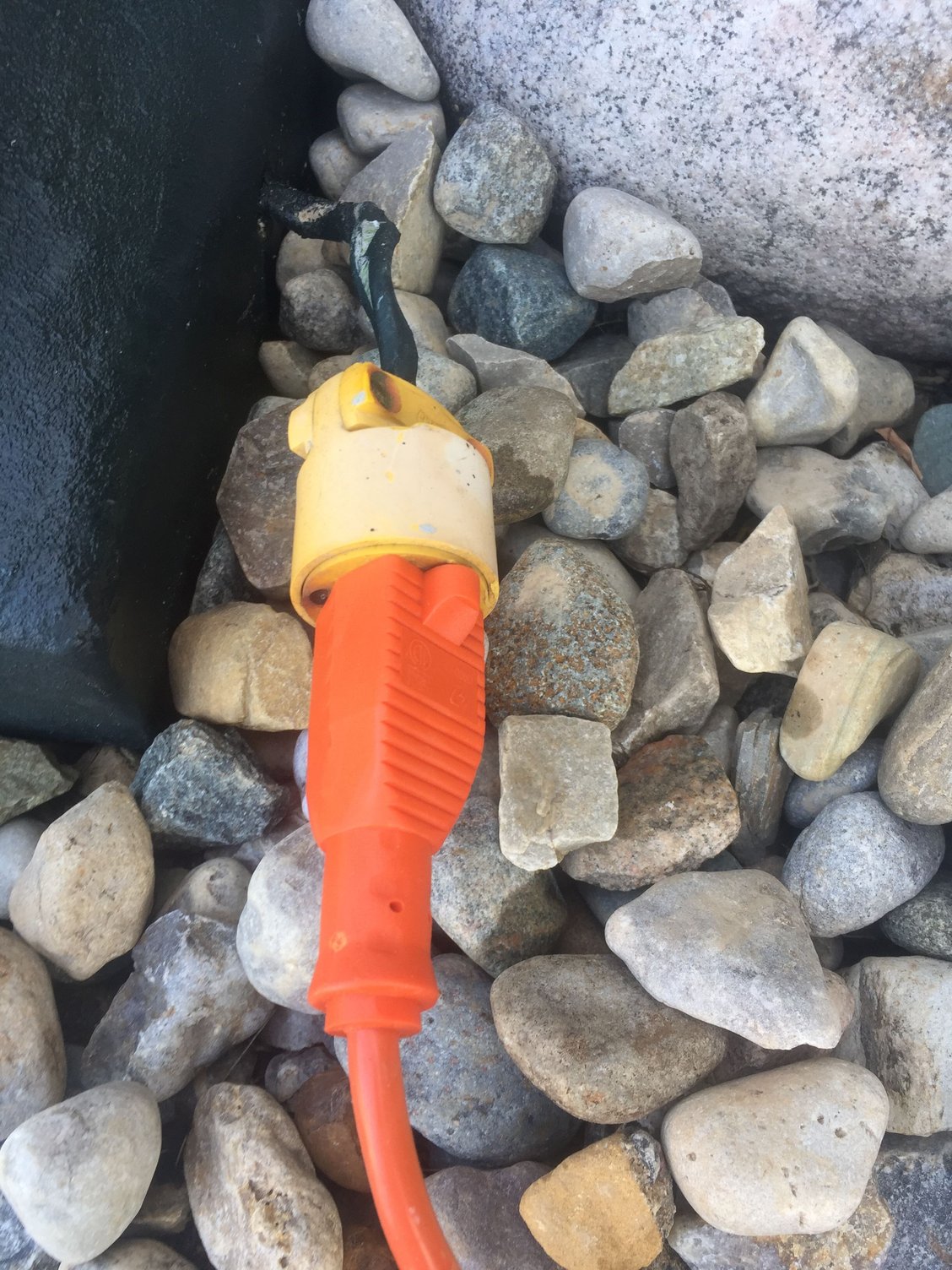

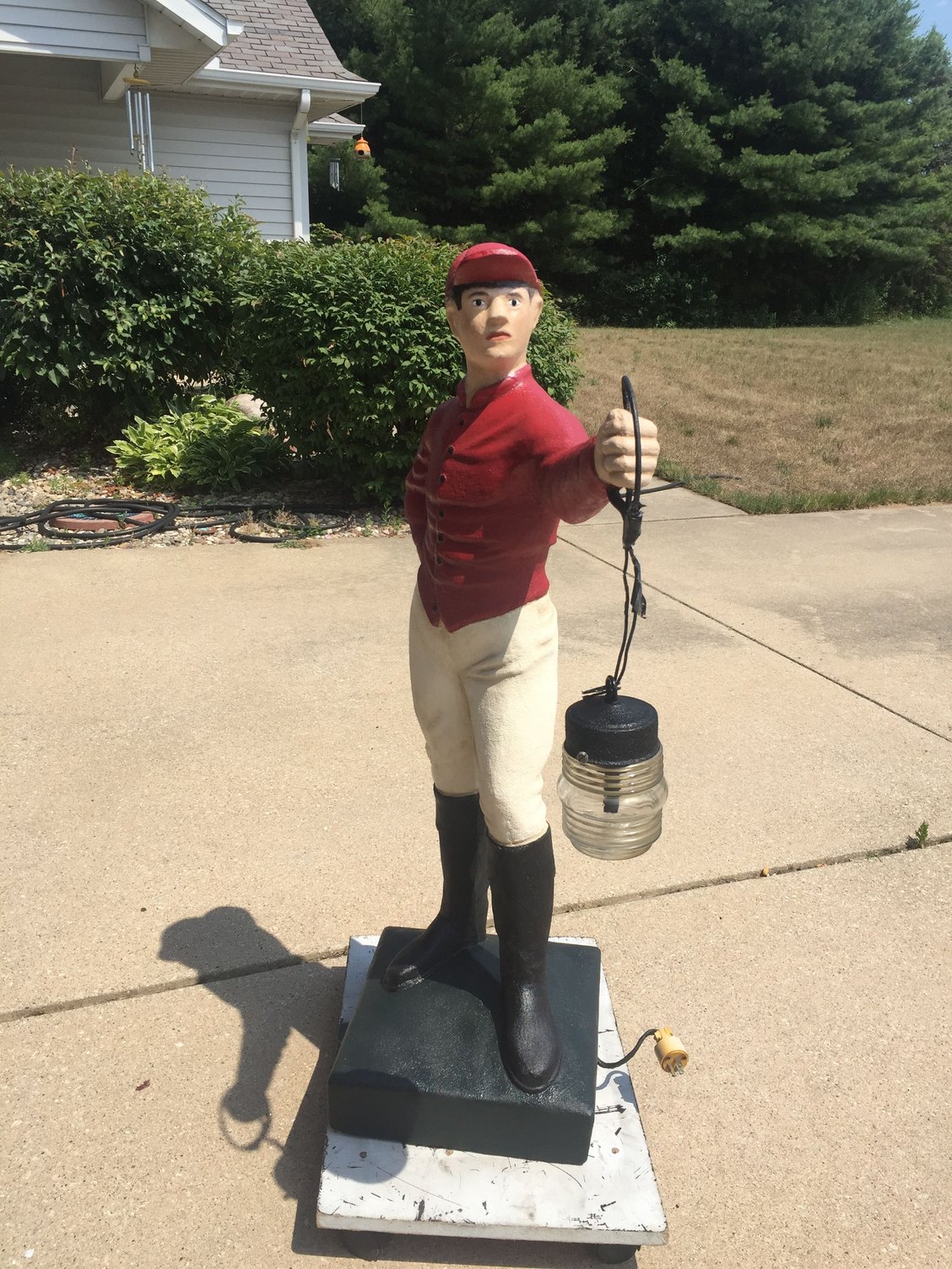

I recently bought and restored a 1954 lawn jockey from an old guy before he moved to Florida with his wife.
When I picked it up from up, he cut the box that the jockey was plugged into and gave it to me, saying "you need a special box like this" and I think he mentioned something about "12- volts"
Anyway, I went to a hardware store, talked with the electric guy, who showed me a standard cord and a plastic joined plug protector, which I bought. And stupidly, I threw away the plugged box that the old guy gave me.
I bought the correct bulbs for the lawn jockey and when I got him all connected and flipped the switch - the bulb blew.
I have been searching around for a low-voltage box that the jockey can be plugged into.
Any help appreciated - see pics.
Thanks
Full Lawn Jockey
Lawn Jockey plug
Standard cord

You mentioned 12 volts in your post but everything in your photo is for 120 VAC. Did you install a 12VDC bulb and then plug it into 120VAC? If so that could be why the bulb blew. Was the box you threw away the 12 volt power supply?

Is that electrical tape unravelling above the lantern?
Also the wire looks like it is split by the plug.
Also it looks like the lantern is hanging from the electrical wires.
All the above indicate that the unit should be rewired and the lantern supported by a chain etc.

Hi, can you post a pic of the old bulb ? that hole thing definitely needs to be rewired, what is in the box he is standing on?

The "box" is a cement block. The wiring goes from his hand down to the block.

That's a 12volt bulb. You need a plug-in transformer to convert 120v to 12v to run that bulb. You can use any 12v AC or DC 1-2 amp adapter. You may have one kicking around the house.

Hi, you have a lot going on there , a low voltage bulb that will require a 120/24 VAC power supply, low voltage wiring that will need to rated for wet locations and a GFCI point of use receptacle to power the power source, if that is a solid block of concrete and the cable is incased thatís another issue, it can be done but you will need to get creative.
