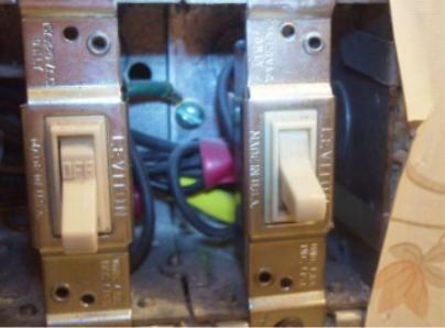

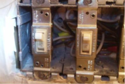

Trying to remove a 4 gang metal elec box.
Apparently it is held in with "Madison Bars". (never seen those before, but found a pic online)
So, if I remove the switches, loosen the wiring, and bend back those tabs - should the boxes be removable? Is there anything else holding those boxes in place? Seems awfully rigid, but I don't see any screws or nails.
I'll try to add a couple pics of my boxes...

Yes the boxes should pull out once you bend the bars straight.

If the wallpaper is covering the box "ears" that might also be helping to hold the box in place.
