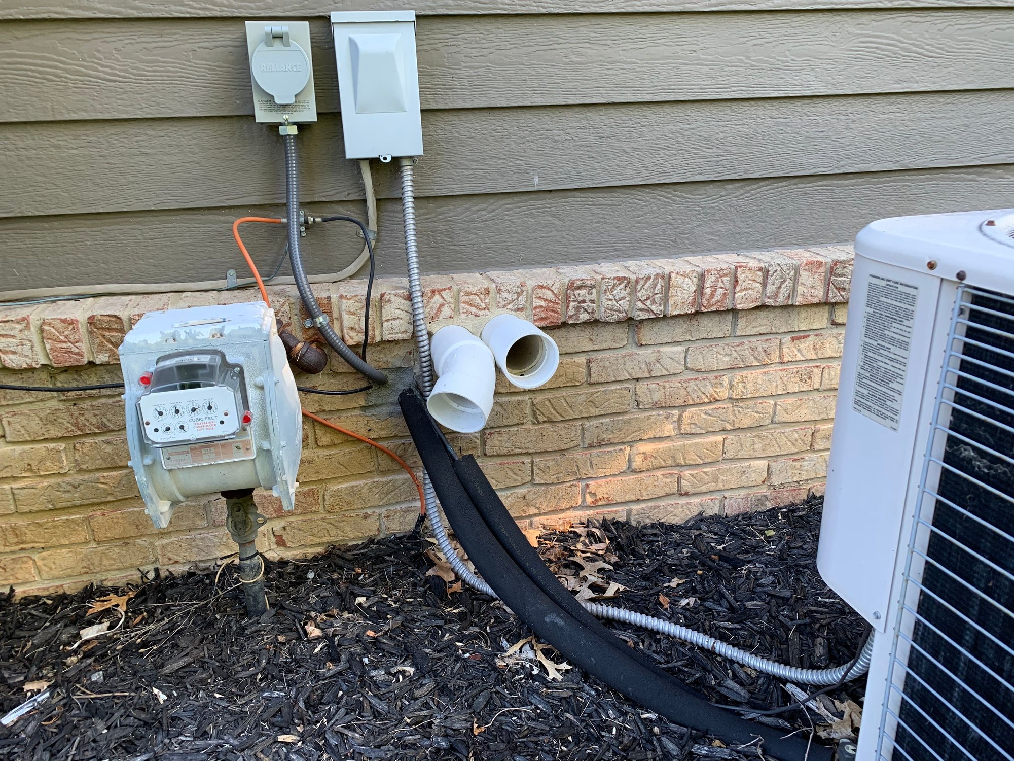

My AC unit is not wired into the main house electrical panel, instead it is wired to a disconnect switch outside and then directly into the electric meter box (see attached pictures). Is there a breaker inside this box, and is this normal practice? House was built in 1994.

There is no breaker in the meter socket. The AC disconnect better be fused.

Open the disconnect, tell us what you find. There should be fuses or a breaker in there.

Yes, you guys are right, there are fuses in the disconnect box.

Wow..... that is illegal and against code.
Not good for a house built in 1994.
You'd better hope it's on the metered side or you'll get a surprise one day.

Hi, you might try shutting everything off in your panel and only turn your AC on and see if the meter reads anything, you better hope it does, or like Pete said you could be in for a surprise.

If the meter socket is double lug what code does it violate?
You're kidding me...... right ?
How about the code of common sense.
Apparently this connection was tolerated back in the 50's. It was wrong then and is wrong now.
Connecting #10 wiring to an unfused source is just wrong. It doesn't matter if the meter is double lugged.
230.82 Equipment on the Supply Side.
Electrical equipment must not be connected to the supply side of the service disconnect enclosure, except:
(2) Meters rated not in excess of 600V.
(4) Tap conductors for legal and optional standby power systems, fire pump equipment, fire and sprinkler alarms, and load (energy) management devices

It appears to be a 200 amp meter socket. I have never seen a 200 amp socket with double lugs. I'd like to see inside the socket and am pretty sure we would see conductors double lugged in single lugs.
I also question the wiring of the condensing unit with greenfield.

So much for services being grouped.

No, I'm not kidding. It was a honest question. So you don't need to be condescending. I figured since the supply conductors looked like they are within the max length of unfused conductors and are servicing a fused disconnect that it could be okay under 230.82(1) as a current limiting device.

I wouldn't be surprised if the wires are connected to the line side of the meter and they are stealing power. I am also wondering what that other cable is coming out of the meter?

The larger cable is the service..... line to the panel.

Here is a picture of the inside of the fusible disconnect switch box. Definitely not stealing power, my electric bill when the AC is running verifies that! From what I can tell, either has to be wired to a properly sized circuit breaker or with a fusible disconnect.

Ok..... in the picture is a fusible disconnect. The gray service cable on the left is the feed from the meter. When connecting anything to the meter directly...... it's before your main panel and protection. That means that piece of gray cable is protected to roughly 400A as that's what an unfused service can deliver. That gray cable should have been connected to a 2P30A breaker in your house panel.
Technically I disagree. That is no different than the service conductors from the meterbase to a 200A main breaker. The service entrance conductors are rated at 200A and the main breaker is the current limiting device that limits the load to 200A. Tap conductors are allowed off the meterbase if serving a current limiting device, which is the fused disconnect. The fact that the service can deliver 400A means nothing when the fused disconnect limits the load to 30A. Conductor size is determined by loads not what the service can potentially deliver. I'm going off of NEC 230.82(1) and 240.21(B)(5). Around here I have seen multiple times taps used off a double lug meter to serve an outbuilding. The key is that the total potential load of the main service entrance and the feeder tap does not exceed the rated size of the meterbase. This is not to say there are not places that don't allow this type of double connection at the meter.

So the A/C disconnect is connected directly to the meter which makes the A/C disconnect another service. The two other things wrong I see here is the already mentioned fact that the two services are not grouped (230.72(A)), and the fact that the minimum service rating of a single-family dwelling is 100 amps. 230.79(C)
Also if this is a new house why is the A/C fed with FMC? FMC hasn't been allowed outdoors for at least 3 code cycles (9 ish years) or more.

That tap is not a dwelling service under 230.79(c) it's a single circuit installation 230.79(a) which is 15A. Plus I'm not sure the disconnect grouping applies to this.
It is not a tap, it is a service. A tap would have overcurrent protection on the conductor being taped.
Is it on a house? (Yes) Then it is a dwelling service.
230.72 pretty much applies to all services of a structure, whether it is a house or a high rise building.
