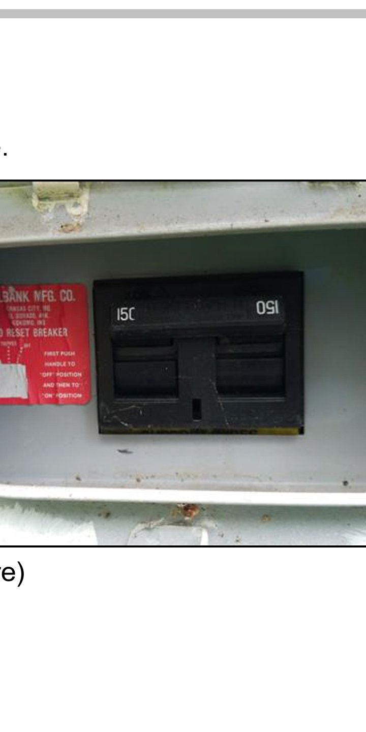

I read in a couple posts that if the meter box has a cutoff switch(service disconnect) , which mine does then it doesnt need SER cable ran from it to breaker box. I read this after writing my original post btw. Not sure if thats true. Also not sure what type of wire will be ran if SER is not needed.

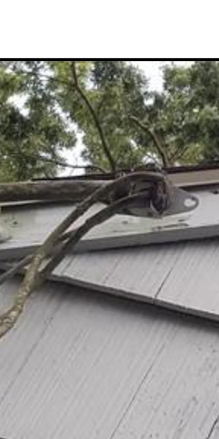

Weatherhead issue , not attached. Also condition of power wires from pole (degradation)
Meter box is awful looking. Maybe its just the glass ? As you know but ill say it. The door under the meter is the 150 Amp cutoff switch(service disconnnect)
On meter box. This is what I am referring to as shutoff switch / service disconnect. Im probably wrong lol

the wiring from the weather head down will need to be upgraded for 200 amps

Is my meter box a meter/ disconnect box ?

You do have a meter/disconnect, so no issue how far away your panel (subpanel) is.
The electrician will replace everything from the weatherhead down. Agreed with the electrician, might as well go to 200A for a few extra dollars for slightly larger wire.
