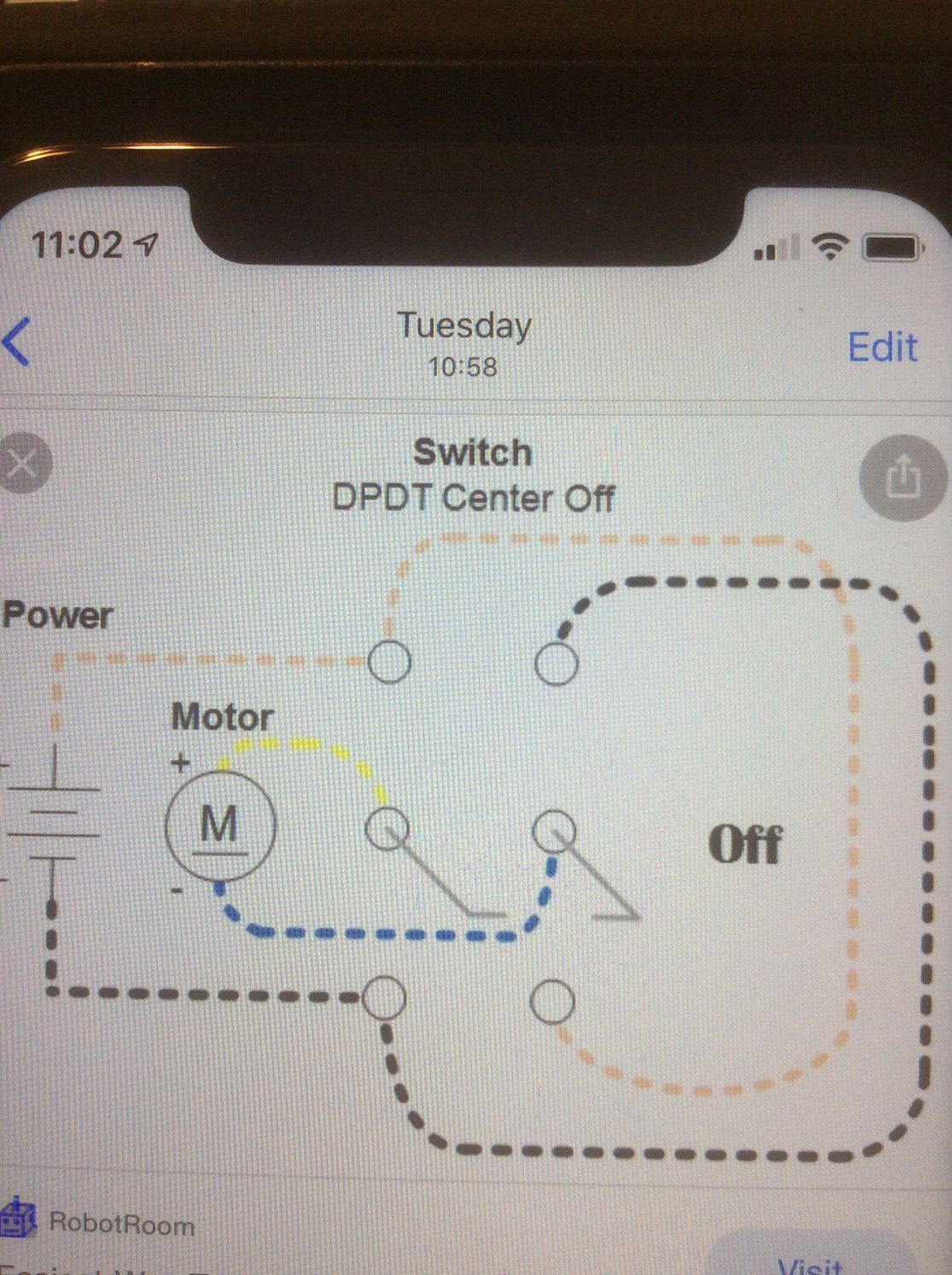

Hello,

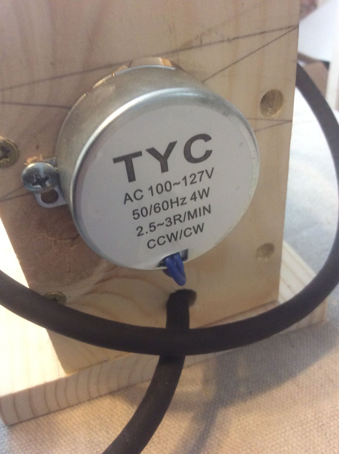

i have this AC motor here, see picture, and wired iit like in the second picture.
Now when I turn it on , it works ok in one direction but when I wanna change the direction and turn the switch in the other position to change the direction, the motor will keep spinning the the first direction. I have to flip the switch several times before it finally change the direction.
Any ideas what could be the problem?
Thank you

suspect the motor some of those small gear motors dont reliably run in only one direction.

Your schematic shows a DC circuit and the motor is marked for AC operation.

I have a 3 position switch and I know that the schematic is for a dc motor.

You cannot just reverse the two input wires to reverse the direction on AC motor.
I have a feeling that motor will start in either direction and you cannot externally change it.
You'd find this type of motor in a microwave oven on the platter where rotation isn't critical.

How many conductors are in the motor cord?
it does show a CW/CCW stamp. Does that blue lever have a known function?

So I just wired a normal on off switch to the motor and every time you turn it on the motor changes direction. So I don’t think it matters how you wire it it will always change randomly the direction.

You can find those motors all over ebay. There are only two wires. A motor that specifies one direction will always start in that direction. A motor specified as dual direction can start in either direction. It would be just like a coin toss as to which way it started.
If you need a true reversible system you'd need to get a three wire motor or switch to DC w/DC motor.

Pete, you're correct about the motors starting in either direction. Like in the microwave. But I don't believe it's random. Every time I open the microwave door during a "cook" it will reverse direction.

'Late to the party' again, but did anyone notice that the schematic is for a DC motor?
