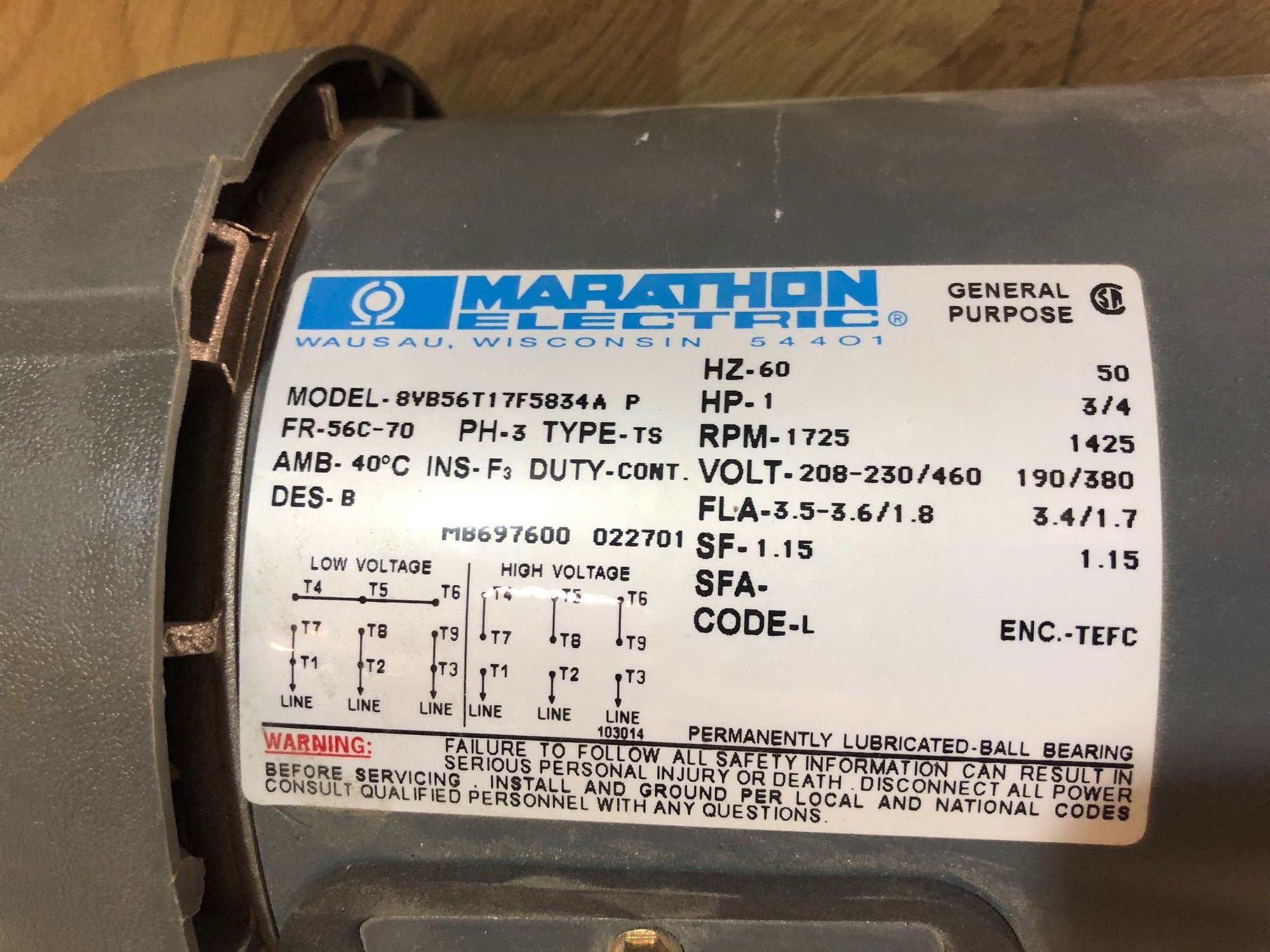

Hi guys. Thanks in advance for looking at my post.
Forgive me if I am a bit too "wordy", but I want to give as much information as I can.
I recently was gifted a really nice mini lathe for woodworking. The person who gifted it to me told me that it was 110v, but the plug in has a different configuration than the "normal" 110v plug in. It is similar in size, but the prongs are horizontal, in line with each other rather than parallel to each other (I see that it might be called a "straight blade" plug). I attempted to do some research, and it seems that that plug configuration works with a 20 amp circuit...which I have installed in my garage, but I ALSO see that it can be rated at 250v ...which is confusing me.
The lathe was made by a Canadian company called One Way. I have the manual, and it says that that particular model was either shipped without a motor, with a 1/2 hp motor, or with a 1 hp motor. The 1/2 hp motor is 110v, the 1 hp motor is 220(240).
I had to pull the motor to get to the spec plate, and it told me that the motor was 208/220/240 (something like that...I may not have that exactly right).
So this seems simple, right...but here is the confusing part for me. The plug, and an aftermarket extension cord are both wired with 14/3 wire (it says so on the jacket). I took off the ends to see and they are wired with only hot, neutral and ground (black, white, green).
Am I safe assuming that this is a 110v connection with a different than normal plug end (probably to ensure that it is used on a 20 amp circuit instead of 15)? If that is true, the motor must have been wired for 110v instead of 220v. How can I tell? What else do I need to do to confirm this if this is not the case?
I'm not real bright, but I would sure like to avoid doing something that is going to prove it.
Please feel free to offer input or questions.

Welcome to the forums.
Absolutely not.
If 120v was not listed there..... then it is not a 120v capable motor. You MUST read the motor nameplate.

Ahhhh.....you added a picture. Very good.
Now the bad news..... that is a 3 phase high voltage motor and cannot be used in a residence.
That should have had four wires on it. One for each phase plus ground.

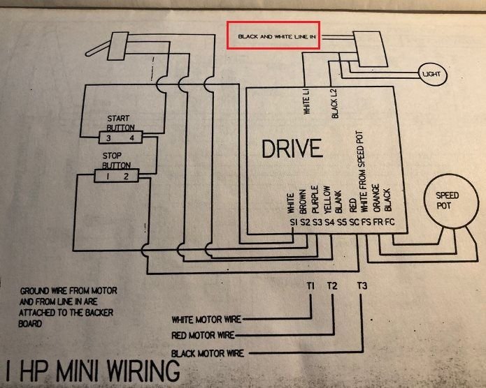

Hi Pete,
Thanks for the response. The box is actually not really labeled in any way...at least not on the outside. It's One Way's "patented" controller box. I did manage to find some info on it in the manual. I should have looked at this before…now I feel dumb. I noticed the 3p on the picture of the motor after I posted it. Sometimes it takes someone like you who knows what they are looking for to add insight (which is why I am here). I read the manual about a month ago, and did not process the part where it says that it is a 3 phase motor that is controlled with single phase AC in, 3 phase out (see pic of page in manual).
I have also included a picture of the page in the manual that has a schematic for the controller box.
Truth be known...You missed the part about the speed controller because I wrote that when i went back and edited the post and added the picture. My fault, not yours.
Can you tell me what to look for (based on this information) so that I can determine what voltage? Is it even possible to have 14/3 wire for a 220v plug in??
If this IS 220v, how do I wire my plug to configure to three conductors instead of 4?

The pictures were a big help.
Wow..... that's an expensive piece. 120v in 240v 3 phase out.
Your power wiring will connect to the white and black wires that I put the red box around.
The green wire will connect to the metal equipment chassis.
So you can run that motor on 120v and it needs to be on a 120v 20A circuit.
That's probably why a 20A plug was used.

We are beating this to death. The cord the OP has is 14-3 and is fine whether used on 120v or 240v.
We need to determine what the line voltage required is for this convertor.
This is not just a variable speed converter..... it's also a phase generator as this is connected to a three phase motor.
