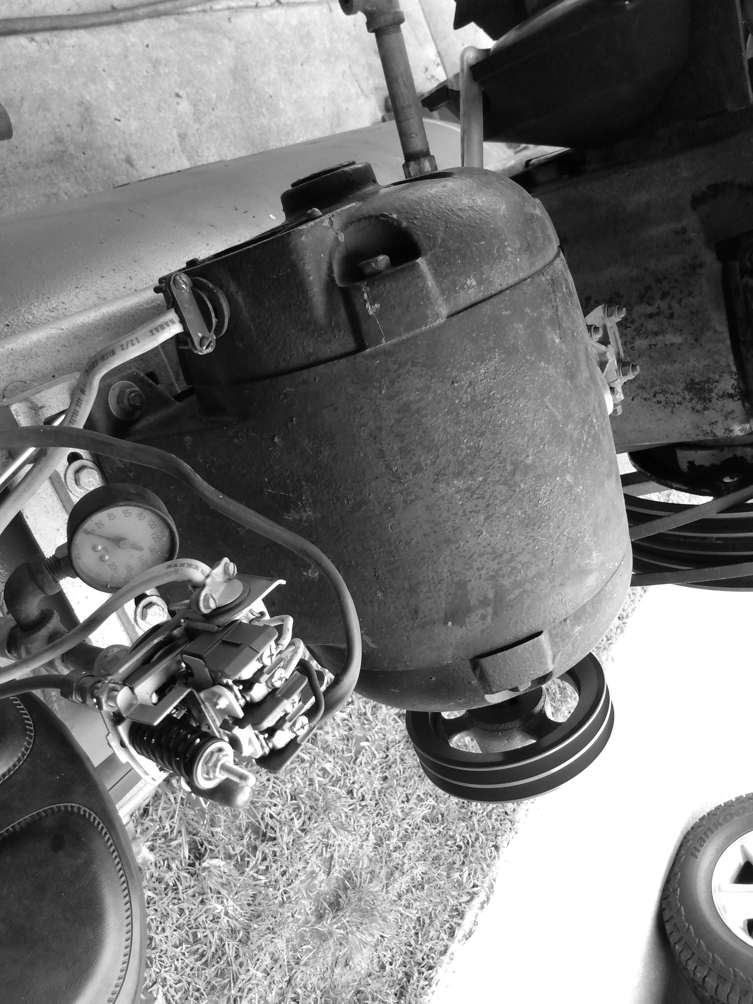

Hi all, I have acquired a huge air compressor. The seller told me that the motor is single phase and it seems to have the correct number of wires. He also said that it was 7-1/2 HP. and it look big enough. It has no labels or markings whatsoever on the motor. The pump is marked Atlas Copco. but the seller said that he was told by the previous owner that the original motor failed and that this was a replacement.
I hooked 220VAC 1P to it and it began to run very slowly and labored then a wisp of smoke came out so I immediately pulled the disconnect.

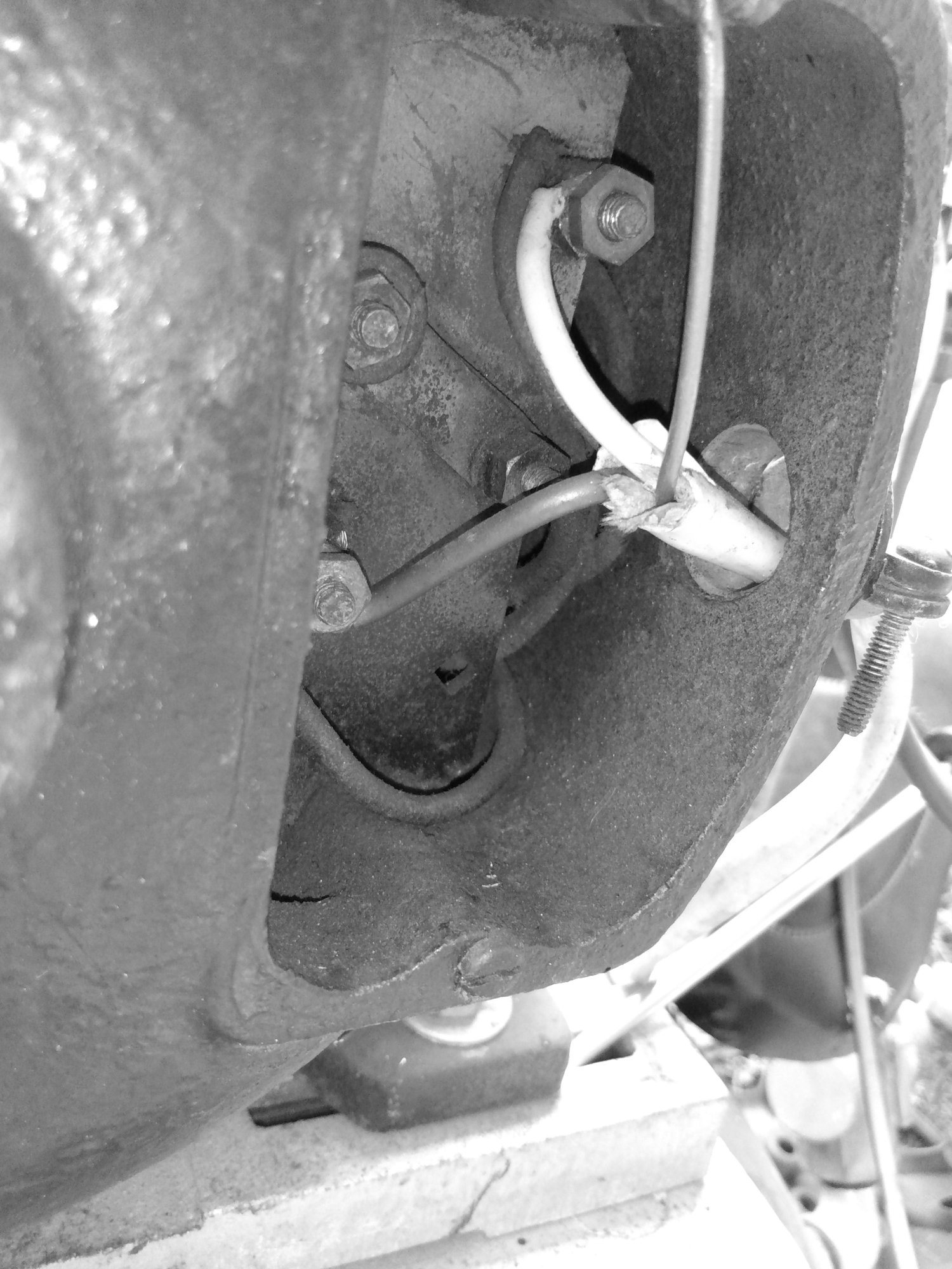

The motor connections are similar to a dual voltage motor and the stator coils seem to be in series. (like a 120/240 motor wired for 240).
Is there such an animal as a 240/480 single phase motor?
I don't think I burned it up, at least I hope not.
Photos attached

Wow..... that's quite an air compressor....and it's going to be loud. Needs some hp to run it.
If that was a 7.5hp motor it would definitely draw well over 20A on 240v.
Typical rule of thumb is 7amps per HP.
No.
I'm wondering about the connection bar in the middle. That sure looks like a 3phase motor.

If the motor is single phase, you should be able to see the centrifugal switch on one end of the motor, usually the end where the wire connections are made. If there isn't one, it is not a single phase. Single phase motors require a starting capacitor connected at the windings. I don't see one in the photo, but it may be hidden or removed before you purchased it. Too bad you didn't see it run before purchasing.

Hi, I opened the housing today and it does indeed have a centrifugal switch, but no capacitor. I think I remember something about Inductive start.
The wires coming from the field windings were labeled 1,2,3,4
I didn't have time to Ohm them out, but I'll do that tomorrow and try to put the field coils in parallel.

I ohmed out the windings and was able to identify the two field windings and the starting coil with centrifugal switch. I put the two field windings in parallel and the start circuit across the input voltage (240VAC). I then closed the disconnect and the motor began to rotate, seemingly without effort and just by observation seemed to be a correct speed - BUT - there was a very loud humming sound coming from the motor. It seemed very unhealthy so I shut it down. The belts are not yet installed so the results as reported are strictly motor related.

Well, PJ, I liked your idea. When I disconnected the start winding, I decided to try starting the motor without the start winding connected. Guess what...the motor started and ran just like yesterday, including the loud humming sound.
What can I conclude from that?

You really need to get a ammeter on the winding to check line current. Loud hum could be sign of shorted turns and lots of current, or something is loose but normal current. In the first case, torque will be low and a rewind is called.

Hi telecom guy, I think you are right on target. I put my Klein clamp meter on the line and it was reading close to 60A. which is way too high. I didn't get a chance to check the torque, but I have a feeling that it is weak. I'm on good terms at my local junk yard. I think I'll paw around in their motor bin to see if they have a good candidate for rebuild. I watched a few YouTubes this morning and I think I can do it. I have an uncle who got filthy rich by rewinding motors after WWII. If I'm going to do it, I'd rather work with a more modern frame. The one on the compressor now could be WWII vintage itself. I would like input on the advisability of rebuilding the one I have. The megger at the pawn shop was purchased by the time I went for it. There are several $50 new meggers on Amazon, but none of them has a hand crank. I'Ve always wanted one of those.
