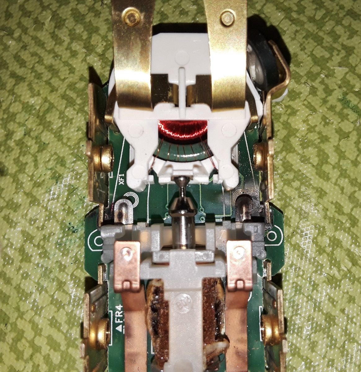

So I noticed with my infrared thermometer that a two year old GFCI was eight degrees higher than ambient with nothing on it. Having seen this with standard outlets before that nearly caught fire, I wanted to take a look inside to make sure there was no loose connection. Flipped the breaker off, took a look, tightened the terminals, all was well, noticed the loop on the hot lead was kind of mangled and thought I should fix it in case there was a hairline crack causing resistance, far fetched but since I'm in there I made a pigtail, good tight pre-twist with a tight appropriately sized wire nut, and put it back on the hot terminal. Flipped the breaker back on, and when I hit the reset button it started buzzing LOUD. There was a 20 to 30 second delay for someone to run and flip the breaker off (I just told them to hit the main since it would be quicker), in those last moments the buzzing stopped and smoke started coming out. With the power off I quickly pulled it back out curious if the wires would be warm/hot. They seemed fine, no discoloration, no charring, no melting. The GFCI felt was warm though, mostly centered near the back and right side (hot side). Put a standard outlet in overnight and fixed it the next day with a new GFCI, new one functions fine.

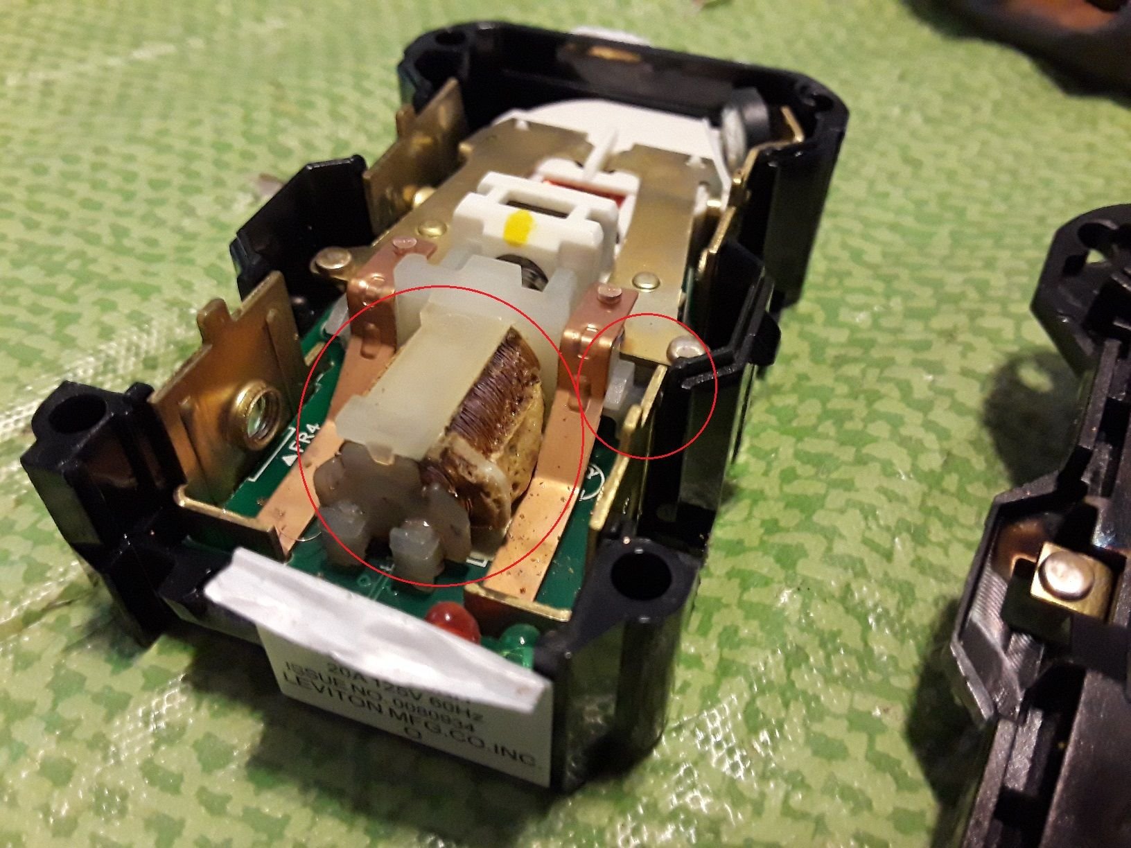

I took the bad one apart (still smells burnt even now) and found some damage inside. Take a look. The varnish on the relay got melted and crispy. And there is one other little lightly charred area close to the hot terminal which should explain the warmth on the right side. Both problem spots are circled in red.
So what could have went wrong? Because everything was fine. No loose connection, no insulation under the terminal screws, hot was on hot, neutral on neutral, ground on ground. Is it coincidence it picked a time to fail after messing with it? Was it the testing mechanism stuck shut? Could that heat the solenoid? But I see no charring or fusing on the contact points, they are still clean. Could over tightening the terminal screw cause do something to damage or push on something inside? This was a Leviton GFCI, bought at Home Depot so it shouldn't be a knockoff or anything. Amp meter seems to indicate nothing else is on that outlet except that one 14 gauge wire. Here's my worry, theoretically if a breaker was unable to pop on an overload due to a short (like the tester getting stuck shut) would the warmest part of the wire be near the short or do I need to worry about the possibility of damaged wire insulation inside the wall? The breakers are pretty old. No visible damage on the wires, and they did not feel warm. So I THINK it was all contained in the GFCI, something faulty in the electronics. Lastly, the new one is still the same temperature so I suppose a GFCI a fair bit warmer than ambient, eight degrees isn't nothing.

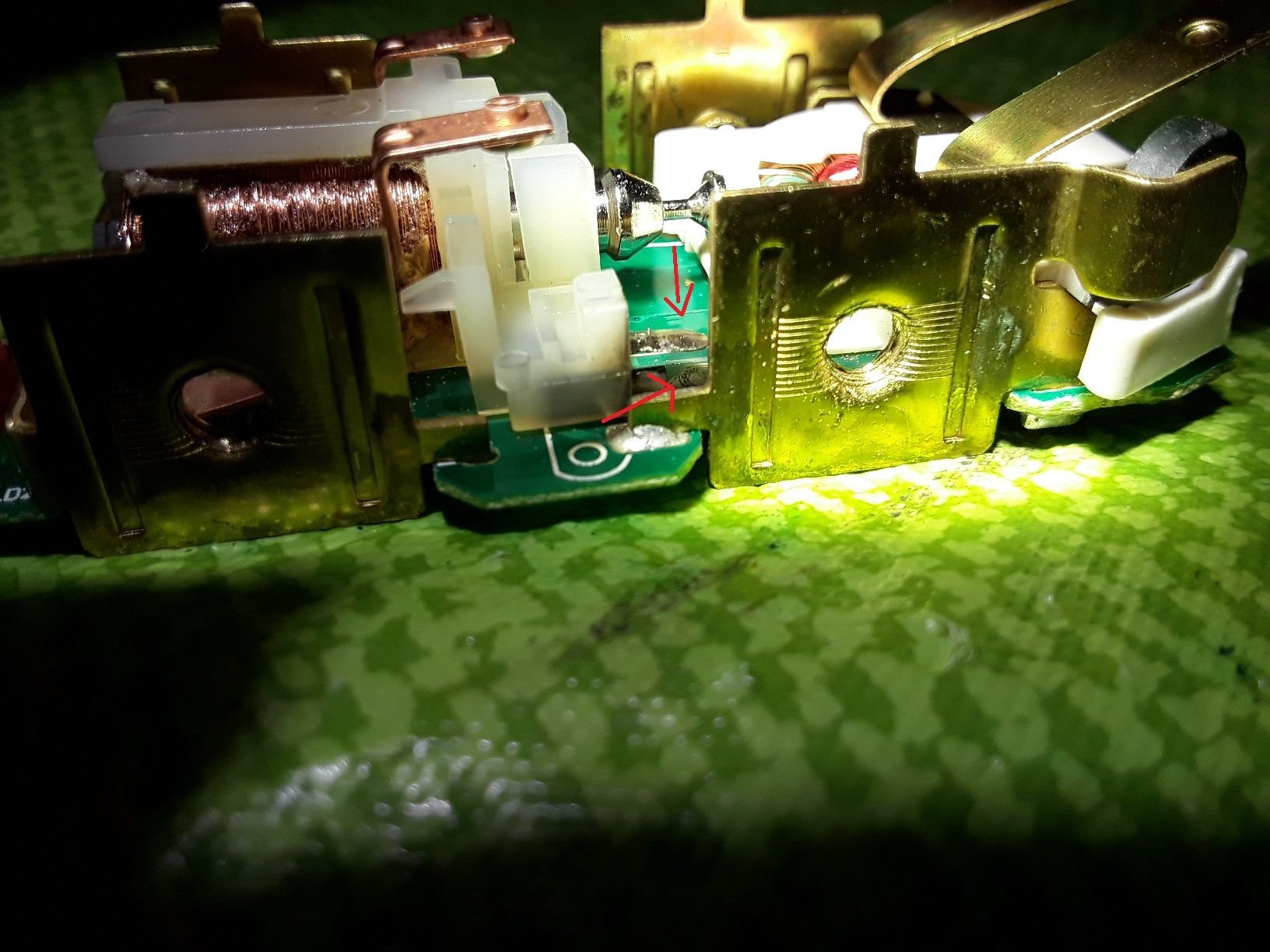

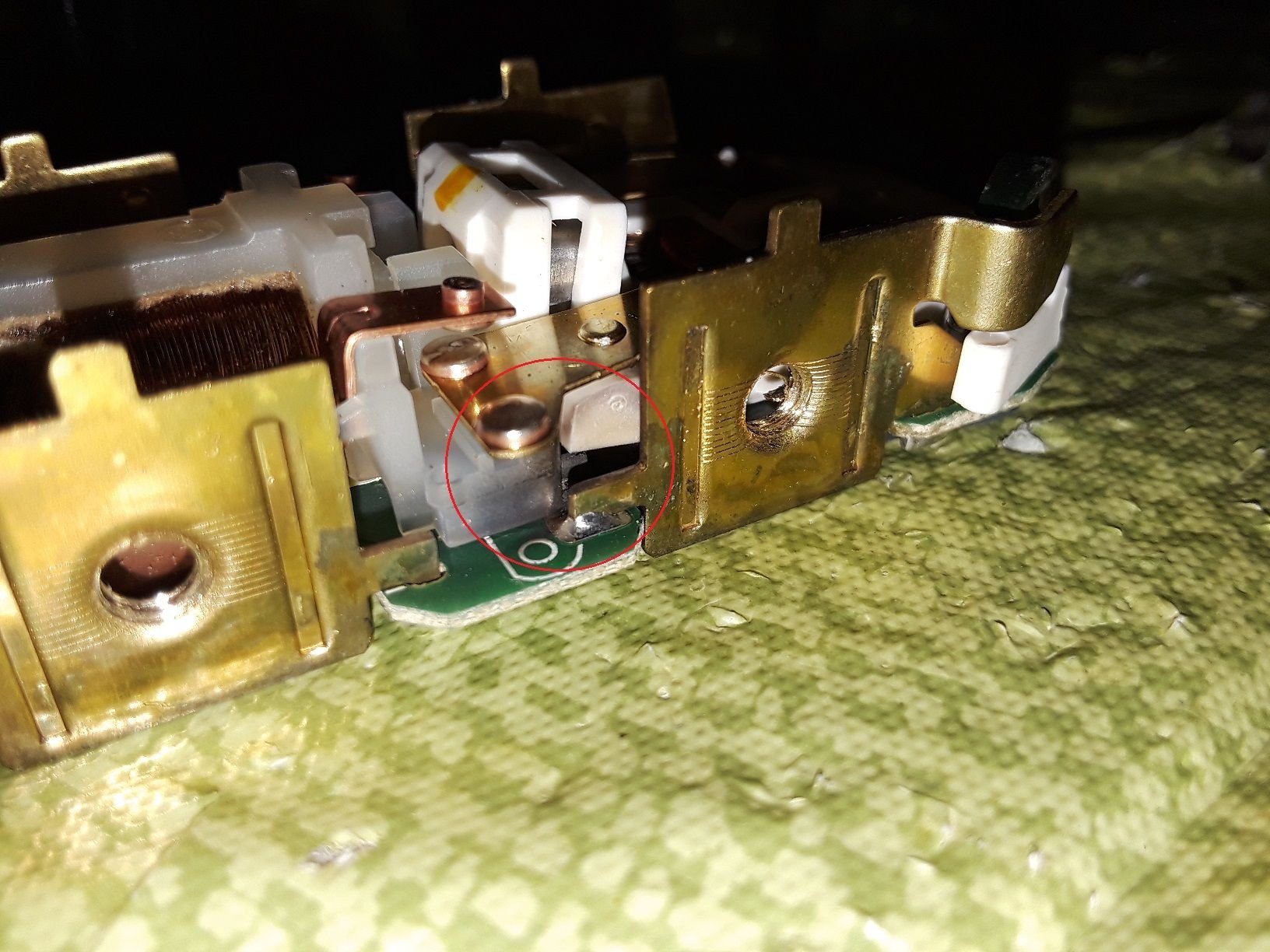

I bent those top contacts out of the way for a better view. It appears there was arcing between these two pieces of metal, there is a small gap between them. Not sure if they ever touch, maybe this is how the tester works? Not sure.
PCB creepage specs are designed to accommodate typical overvoltage events, such as lightning. Also, to accommodate high humidity conditions. The raw PCB itself has specs, resulting in passing tests called CTI, if you want to research that one. All that said, it appears this arc could have been initiated by an overvoltage even that exceeded the standard it was designed to. Was there any history of a close lightning hit? or a flood?
In the end; time to replace the unit.
PS; note the "FR4" that is silkscreened on the PCB. That indicates a fire resistant blend of materials was used in the fabrication of the raw pcb. If it didn't have that, your wall might have been involved too.
