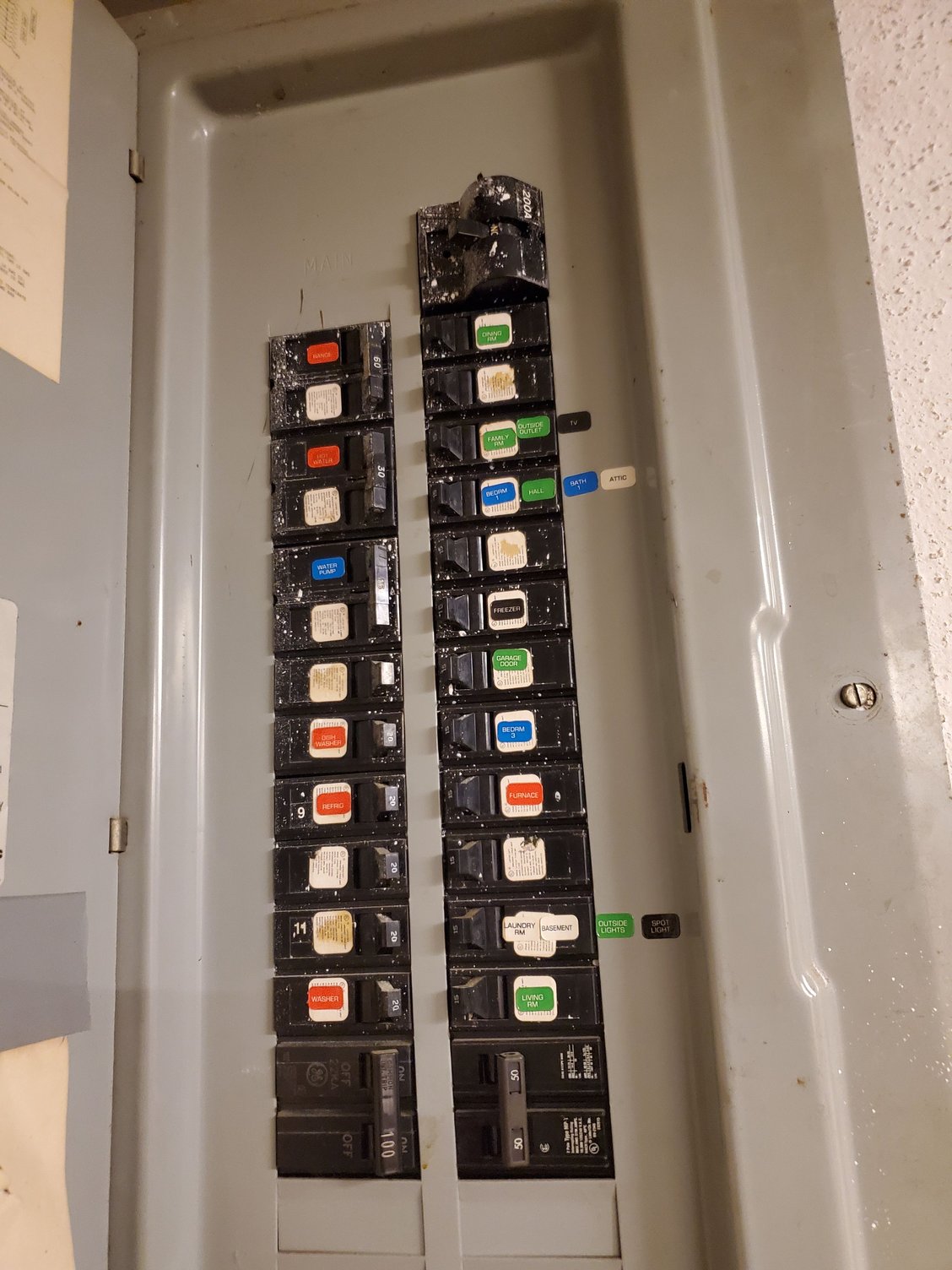

Hello,
I've recently bought a house which needs some things updated (built in 1988). I want to buy a backup generator, but I've been told the current setup is unsatisfactory. What I want to do is replace the current recessed inlet with a proper inlet box, move the top two right breakers below the main breaker and switch them with the double 50A breaker at the bottom ( breaker for inlet), install an interlock kit. Because the 50A is at the bottom, it needs to be relocated beneath the 200A main so that the interlock can function, right? Will it be hard to complete this relocation? The two breakers below the main are for our dining room (1) and a hot tub (2) (hot tub is gone now). I may also need to replace the old hump style main breaker with a flat one. Is this easy enough? If this is possible, I'd like to do it myself. Any advice is welcome and appreciated. Thank you.
Breaker panel w/ old generator outlet below it
Main panel up close
Breaker descriptions
Old outlet that I want to replace with a new male outlet

Looks like a reasonable approach, as long as an interlock kit is available and certified for your panel.
Easy enough to relocate the breakers. If the wires to the top two breakers are too short, you can splice in additional length (of same gauge, don't use smaller gauge).
How do you plan on shutting off power to replace the main breaker? Remember, the cable feeding the main breaker is live unless you pull the meter or this panel is a subpanel (in which case, the whole concept of installing the generator breaker here needs to be revisited).

I didn't think of that. I know they make kits for the hump style breaker, so maybe I need to start looking at those.

Alternatively, hire an electrician to change the main breaker. An easy and quick job for them.
