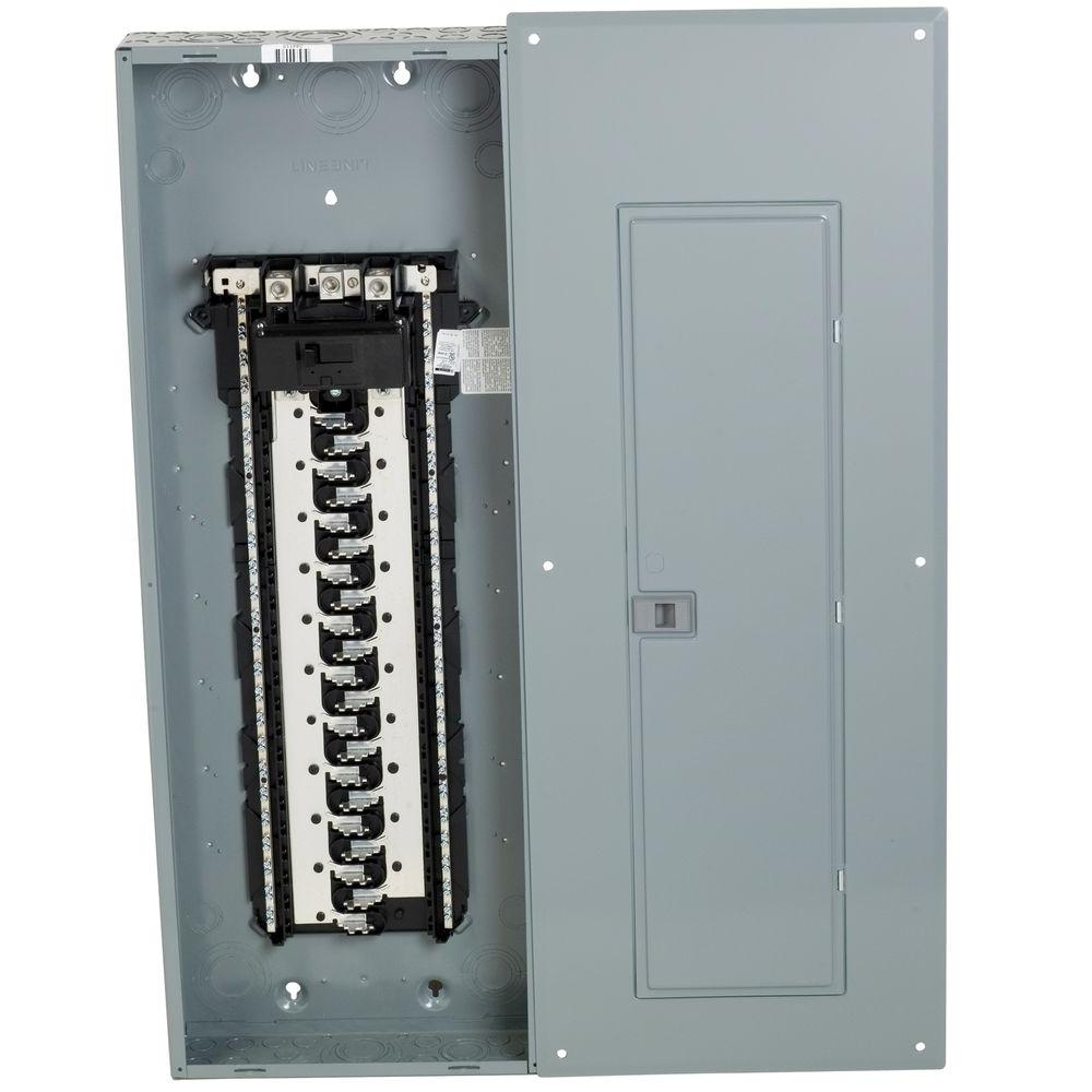

I am wiring a new home I am building and need to add a second neutral bar to my load centre and need advice.
I have a 400 Amp Service entry from Eaton (CPM442) and it has only one neutral bar on the left side. Eaton sell a kit to add a second bar (CPM400 kit) but so far, technical support can’t tell me if the kit comes with installation instructions. I am balancing the load on the panel, with all my 240 volt circuits at the top ( they are numerous : I heat and cool geothermally, and in addition to oven, stove top, dryer and hot water, run 240 volt machinery in my wood shop).
At issue is that I have 16 plug circuits that are required to be protected with AFCI breakers, and need to put half on each side of the panel. Obviously, the pigtails on the AFCI breakers won’t reach the neutral bar. From what I have read, I could add neutral pigtails to the breaker pigtails connected with a wire nut but that starts looking messy. My preference is to have a second neutral bar on the right side of the panel.
From reading other posts and forums, if I understand correctly, I can mount the second bar to the panel and run an insulated neutral wire to the large terminal on the left side neutral bar. I would the largest gauge wire the terminal will accept, either 4 or 6 copper AWG.
Am I correct in this assumption, and is there anything I need to be aware of?
Looking at Eaton's docs the plug on neutral is not available for 400 amp panels.
Get the kit as it is the correct solution. Don't muck up a new panel with a DIY modification.
Neutral kit for 400 A combination loadcentres iCPM400KIT - i Kit includes 2 neutral bars.
Yes Joed, I could do that but then most of the 240 volt breakers would be on the right leg and although I am not sure if it is necessary, I was trying to keep the amps balanced on each leg.
If you had only 240V circuits, they are automatically balanced because each double pole breaker is in contact with each of the two incoming hot legs.
If we make the totally unrealistic assumption that all your 120v circuits draw the same amperage, and do so at the same time, you could put them all on one side of your panel and be balanced because half of the breakers would be on one hot leg, and the other breakers would be on the other hot leg. The bus connected to each hot leg zig zags as it runs down the panel, so thinking "left side" and "right side" has nothing to do with load balancing.

My thought was to have all the 240 volt circuits at the top of both the left and right legs, and then have the remaining circuits equally distributed down each of the legs.
Let's try this with a picture.
Can you see that if you install breakers on ONLY the left side, half the breakers will be on line 1 and half the breakers will be on line 2? By the same principle, any 2 pole breaker (your 240V breakers) will be on both line 1 and line 2.
Make sense now?
