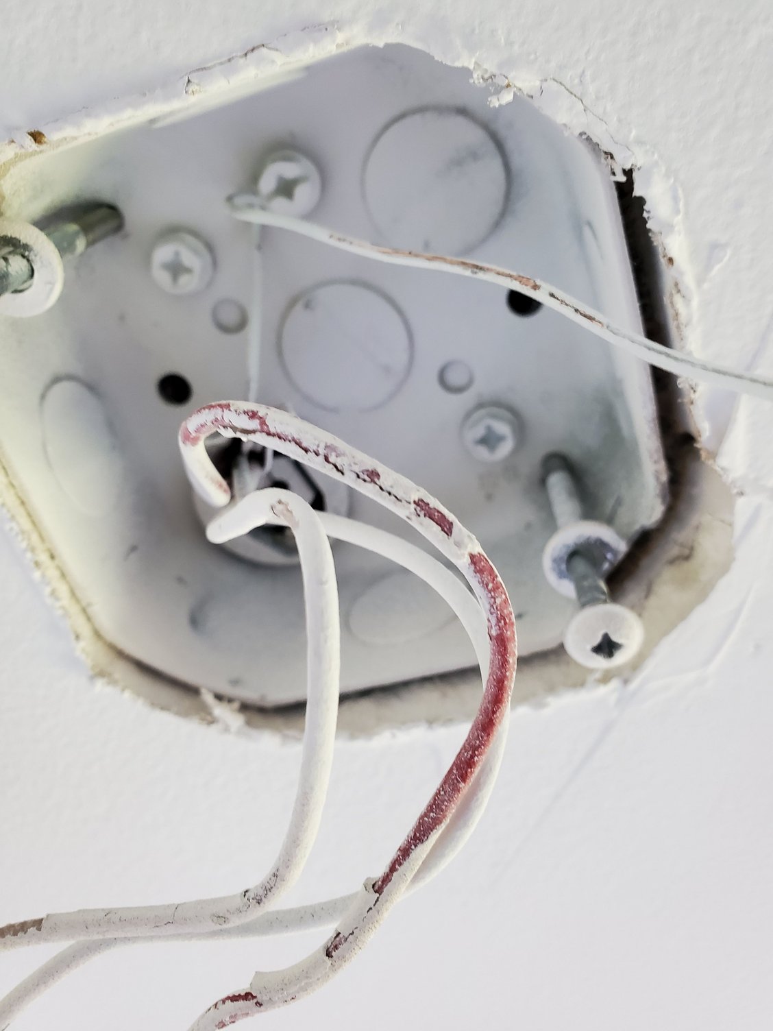

At one property, we're seeing this when the light was removed to install a fan. Shall I assume this is a bonafide ceiling fan support box?

That is a fan rated box. .
