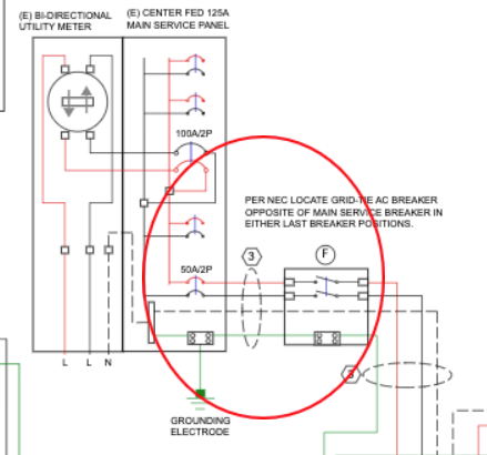

Hi. I am installing a solar system and need to connect the critical loads (sub)panel to the mains center. The specs are three 8 AWG conductors and a 6 AWG ground. But when you look at 8 AWG NM cable, the ground is always 10 AWG. No go. So I am thinking I'll use 6-6-6-6 SER instead. This will be mounted in a wall between two studs. Are there any code considerations for protecting this concealed short run to protect the SER? E.g., attaching it to the stud, etc.

I am attaching the relevant section of the schematic.
The main panel is on the left. The AC Disconnect ("F") is on the right. "3" refers to the wiring key: Three 8-AWGS THHNs, plus a 6 AWG ground. Since there's no NM cable like that (It's all 8-8-8-10), I need something with a 6 AWG ground. Hence SER 6-6-6-6.

Hi, how long will this SER be? can you use flex and individual conductor? most connectors are only rated for 2 cables, as for labeling circuits I doubt the AHJ will make label existing, I would probably label anything you move.

Bottom line: I need a very short run of AWG 6-6-6-4 inside a wall cavity.
This is for a 50-amp branch circuit from my main box, through an AC disconnect switch.
I don't know what kind of conductor to use from the AC Disco to the breaker. The distance of the run is about 12" or 18".

The cables entering the top of the panel do not meet code now. You cannot insert the SER the same way. They need to be clamped to the enclosure with proper connectors.

Just to clarify: this is part of a branch circuit, and the conductor would leave the AC disconnect with a clamp connector and enter the main box as part of a bundle through the hub hole at the top about 8 inches away, all inside a wall cavity.
I went to the electrical supply store yesterday. It was hard to understand the Chinese man who helped me (through his mask), but he sold me 2 feet (avoid derating) of copper 8/3 "Lumio"? jacketed cable.
The ground in the jacket was too small gauge so he sold me a separate 6 AWG coated ground wire and said I could strap/tie it to the 6/3 because it was "not a conductor".
Does this still sound like a violation?
