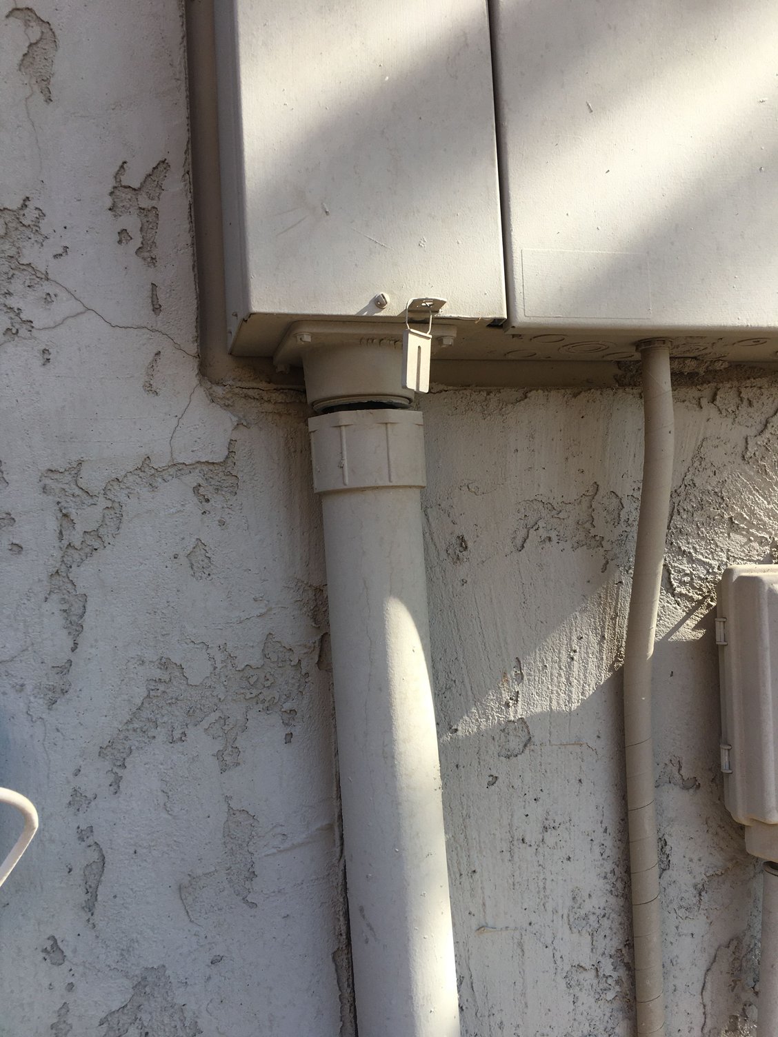

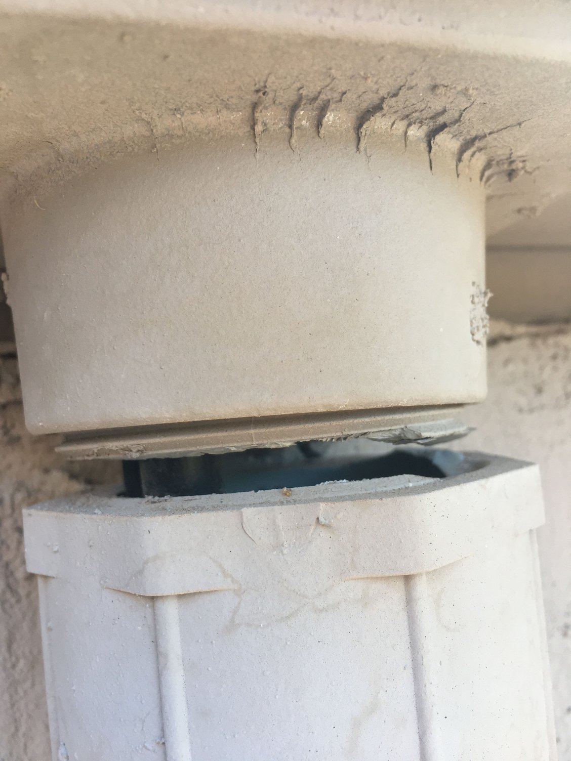

Broken electrical conduit fitting on house meter
Hey Team, anything I can do about this, short of a major repair. Thanks

Are they proposing to run new cable all the way?
I don't see any reason to cut side walk.. Hardest and possibly most expensive part of the job is having power company cut power and reconnect.
Once the power is cut, it is fairly easy job. Just have to cut the conduit and glue new piece, ideally with expansion joint.
If that was my house, I'd just seal the gap with duct seal or caulk or maybe epoxy putty and wait until gap gets bigger. This fix may not be code compliant, but don't really see any immediate danger.
Often these underground services are direct buried without conduit and conduit is just there to protect above ground wire from damage.

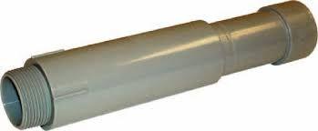

It's repairable but not by a homeowner. You'd need to have the PoCo disconnect power at the street. The wiring gets disconnected from the meter jaws. The pipe gets carefully cut with the wires inside. The broken male PVC connector gets removed.
That connector will be replaced with an expansion coupling like in the picture and made by Carlon.
This fitting telescopes up and down to account for pipe shrinkage and expansion.
By code.... a new lateral service would have this fitting from the start.

No.... the power company is not responsible for that part of the service. That repair will be up to you.
