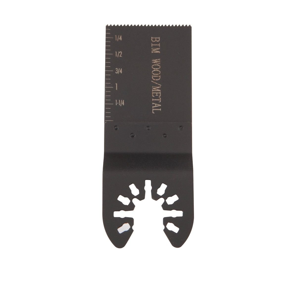

Seems I'd have to remove the box and install an old work box (the style that secures itself to the drywall by use of ears rather than securing to stud) to avoid cutting and patching drywall. To remove the box, I'd have to cut the nails, so I'm thinking this kind of blade for my multitool (and carefully using after moving cables as far out of way as possible).
Hacksaw blade is another option, but it would take forever with such short strokes. Other options I should consider?
Actually, that will be very fast and easy unless you have very dull blade.
Put hacksaw blade between junction box and stud, not inside of the junction box. The nail will cut very easy.
I do this often with plastic junction boxes where nails are outside and hidden from the view.

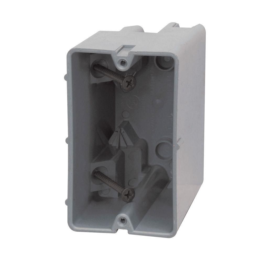

Existing drywall opening might be too big to install a remodel junction box though. Might have to use regular plastic junction box and drive screws from inside. This technically is against the code, but done very often.
https://extremehowto.com/wp-content/...ghtTT18&19.jpg
There are special junction boxes that are made to be screwed from inside, but not easy to get locally.
https://www.galesburgelectric.com/ar...angled-screws/
Ah. I was thinking inside the junction box, which I was thinking it would be very short strokes. Good call on going outside, keeps the cables out of harm's way too.
Good point. I suppose I could patch and recut the hole, but it would probably break at the patch joint when cutting. So yeah, I may have to drive screws from inside, and try to keep the box close to flush and square while doing so.
I found a similar box, the Madison Smart Box. From the 360* view on Lowes site, it looks like built-in 1 x 12g and 1 x 14g NM clamps on each of top and bottom of box. So could be an issue for old work where someone has 2 x 12g cables running to the device w/o enough slack for one cable to enter from opposite side of box.
https://www.lowes.com/pd/Madison-Ele...Box/1000156805
The reviews for this box on Amazon are very positive and very numerous, which indicates lots of people are using these, and they are listed (UL), so maybe it is code compliant?
The Arlington box you linked uses different size KOs, so no problem getting 2 x 12/2 into box.
Easiest to source might be these new/old 1-gang boxes at Home Depot:
https://www.homedepot.com/p/Carlon-1...25AB/305110267
Apparently for old work, you break off the stud face mounting tab, and use screws at interior mounting location and toss the nails.
