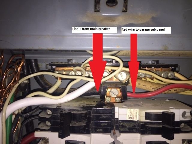

If both my panels have a 100A main breaker, do I really need another 100A breaker in the main panel to feed the subpanel or can I connect directly to the panel somehow?
The main panel does not have any other breakers in it, all of them are in the sub panel....

The only way to connect the wires to the main panel is with feed-through lugs as Pattenp mentioned, or from a breaker. You may not put two wires under a single lug.
If the sub-panel is in the same building it does not require a main breaker, you may use an MLO (Main Lug Only) panel.

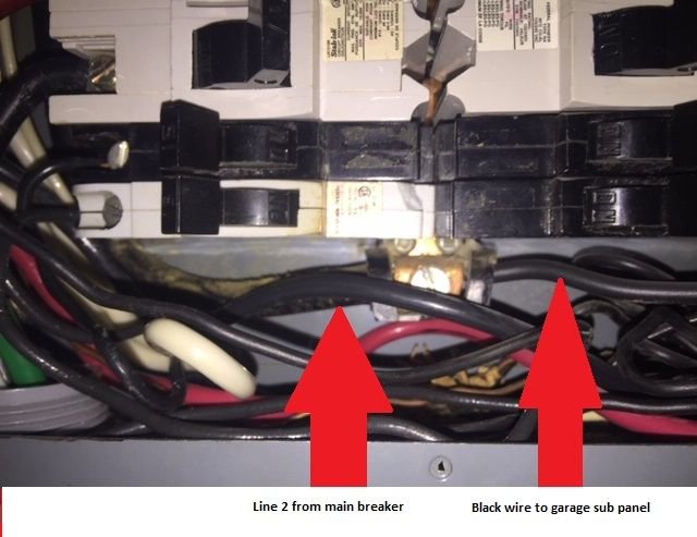

So there does seem to be some feed-through lugs on this old panel. It looks like the garage subpanel is already attached to them. Can I also put another subpanel on to the same lugs together with the garage panel feed?
I have attached a picture of both lugs - one above the breakers and one below the breakers....
If you post a picture of the entire panel we can make suggestions to properly wire your panel.
Hmmm... well it has been like that since the 60's I am guessing. The feed wire from the breaker is much heavier gauge than what goes to the garage (my pics aren't that good....
Your main panel.....is that a Federal Pacific or Federal Pioneer panel? I believe it is so my suggestion is to replace it with a larger panel that does have feed-thru lugs. I think I would replace it with a Square D QO panel.
