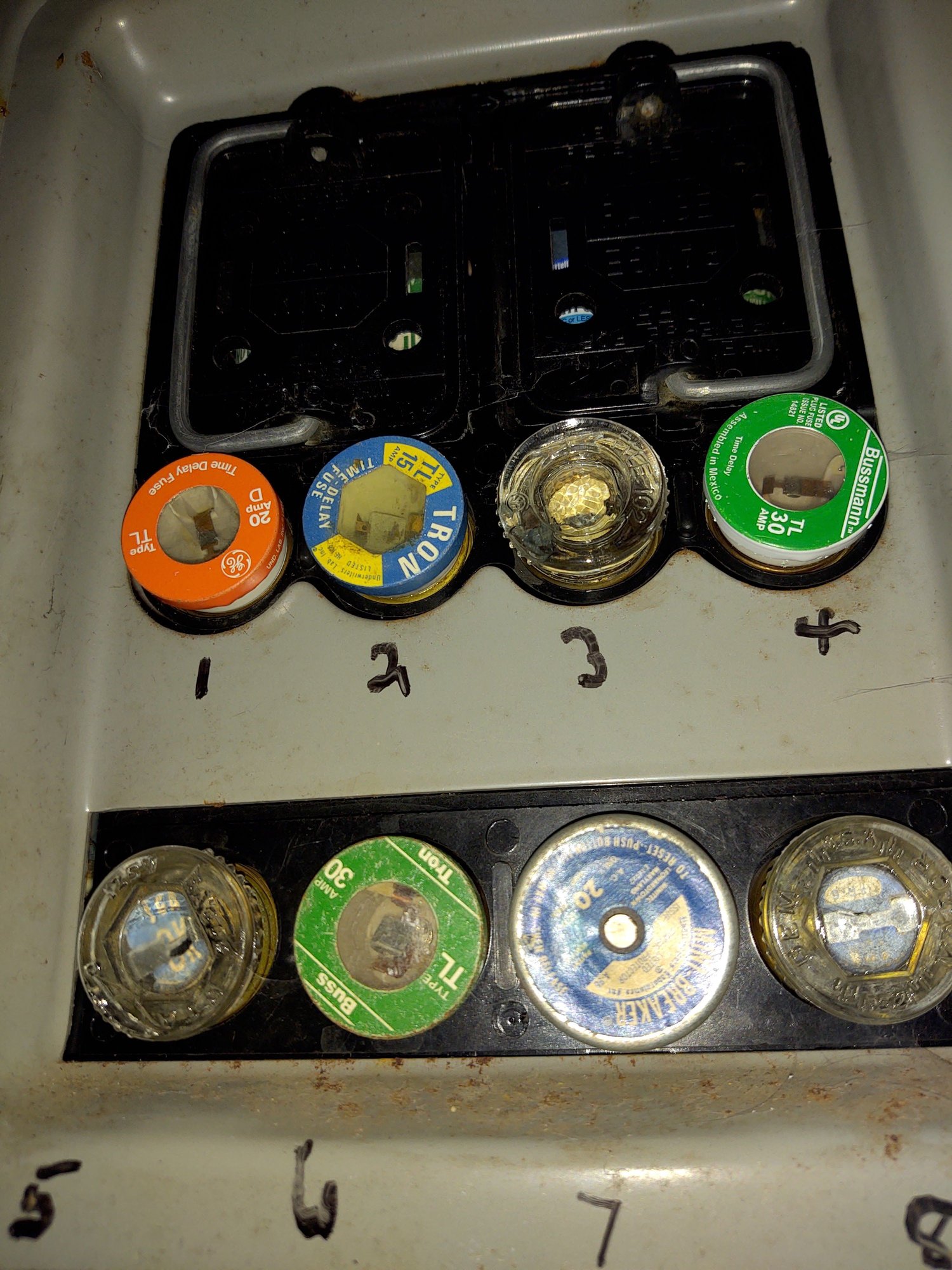

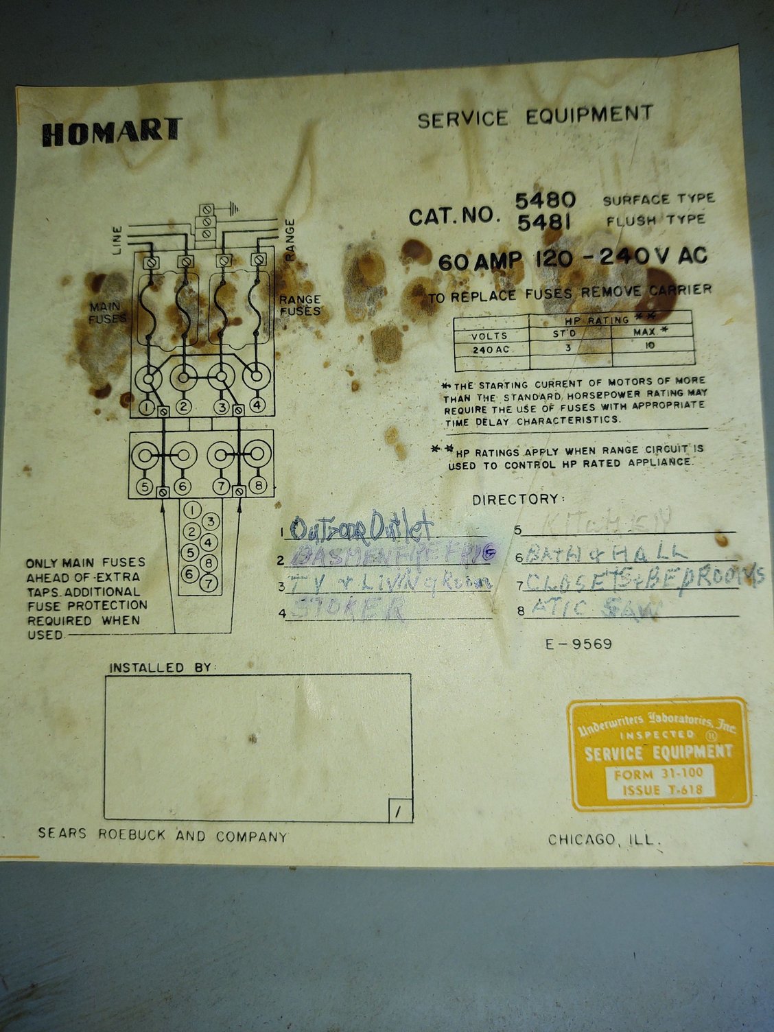

Hello everyone! Newbie on here, just bought an old house and I've got a 60 amp Fuse box made by Homart. I'm trying to figure out how old the box is and see if I should replace it. I live alone and I'm a light user of electronics so I could live with 60 amps (I lived on a boat with 30 for a year) but it may be too old to keep. If anyone can help or comment
Panel info....no date
on the attached pics I'd welcome your feedback.

Those fuse are over sized. You need to change the #4 bathroom to a 15amp and probably the #6 also.
There is a good chance that all of them should be 15 amps. but that needs further investigation to see if the circuits have #12 or #14 cable on the circuit.
If you replace it you likely will need a whole new service. 100 amp would be smallest that would installed.

Fuses perform the same function as a standard circuit breaker, they are just not as convenient. At least follow Joed's recommendations and make sure the wires are properly fused. Then, I would recommend budgeting for a service upgrade at a later date.

Homart was an early manufacturing subsidiary of Sears. I don't remember ever seeing those panels by themselves. They were usually found with Homart homes and were offered as part of the house package. That fuse box is most likely from 1940-1950. The link below is a little history on Homart homes offered by Sears Roebuck.
Homart homes
