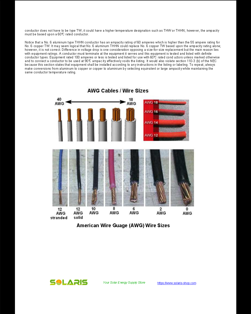

Where did the chart come from? Good question. Here is the background. I am an instructor and received this chart as part of a presentation being given to students. The previous instructor must not of dwelled on the meaning of each column, or didn't see how far off the values were. I didn't have the full document, so went here to find it online:
https://studylib.net/doc/25291894/am...tor-size-table
Zorfdt I now see where you got the quote.
So, now, I believe you all are correct, this is a chart out of a physics book and is nothing more than using calculations to come up with a base number for each column, based on the diameter or CM of a copper conductor.
At the bottom of the document, in addition to the previously mentioned quote, is this:
"For reference, the National Electrical Code (NEC) notes the following ampacity for copper wire at 30 Celsius: 14 AWG - maximum of 20 Amps in free air, maximum of 15 Amps as part of a 3 conductor cable;..."
That 20A rating far exceeds the 5.9A value in the chart.
So, this tells me: 14AWG copper conductor, at 30 C or 86 F, in free air environment, will fuse (melt, liquefy) at 20A. This would be true, no matter the length of the conductor. With these specs, you could create a fuse using 14AWG copper conductor, either within a fuse cartridge of free air?

The answer is: That Table Is From A Solar Power Installer.
That GENERALLY means 1) DC power, 2) low voltage 3) outdoor installation exposed to the elements, and 4) wide temperature swings during operation.
That array of limitations requires VERY conservative numbers for 'wire diameter per amp' as you've seen.

It helps to read it in context- two different measurements.
If you have a solar panel providing sustained DC power to a battery, the screw connections at the power bus will melt with a sustained current around 20 amps.
If you have an AC wire, you need a pulse of 166 amps to melt the wire.
