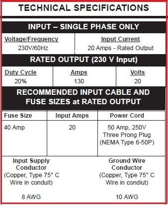

Just purchased a Honda generator to use during power outages and possibly light mig welding use.
Discussion came up if using the 20 or 30 amp generator outlet to power the home could it damage components in the circuit, the majority of the breakers in the panel are either 15 or 20 amps?

Has range type 50 amp male power cord that plugs into garage arc welder outlet during power outages.
It will work if you are very careful and make sure the main breaker is off, but the fact there is a possibility of electrocution makes it very dangerous.
Installing a proper transfer switch with a generator inlet does not cost that much.

Good choice in generators.
Looks like it should power your welder ok.
Make sure nothing else is connected when using the welder.
You will have to run it off the L14-30R 120/240v receptacle.
Since that's a four prong receptacle..... you'll need an adapter cable to connect your welder.
L14-30P to Nema 6-50R........ Adapter cable.

The adapter arrived yesterday, I have never used the Lincoln, or a mig welder for that matter, I swapped for an automotive part many years ago and because there is no 220 to my work area so this will be a first. After I confirm the generator will power the unit intend taking it to a weld supply shop and have them go thru it, looks in good condition.

I've run my MIG off a Honda EU3000i so I'm sure yours won't have any trouble especially with it turned down for thin sheet metal. Sometimes it is easier for me to put the generator and welder in the tractor's bucket and carry it to the work instead of dragging the work to the shop.
