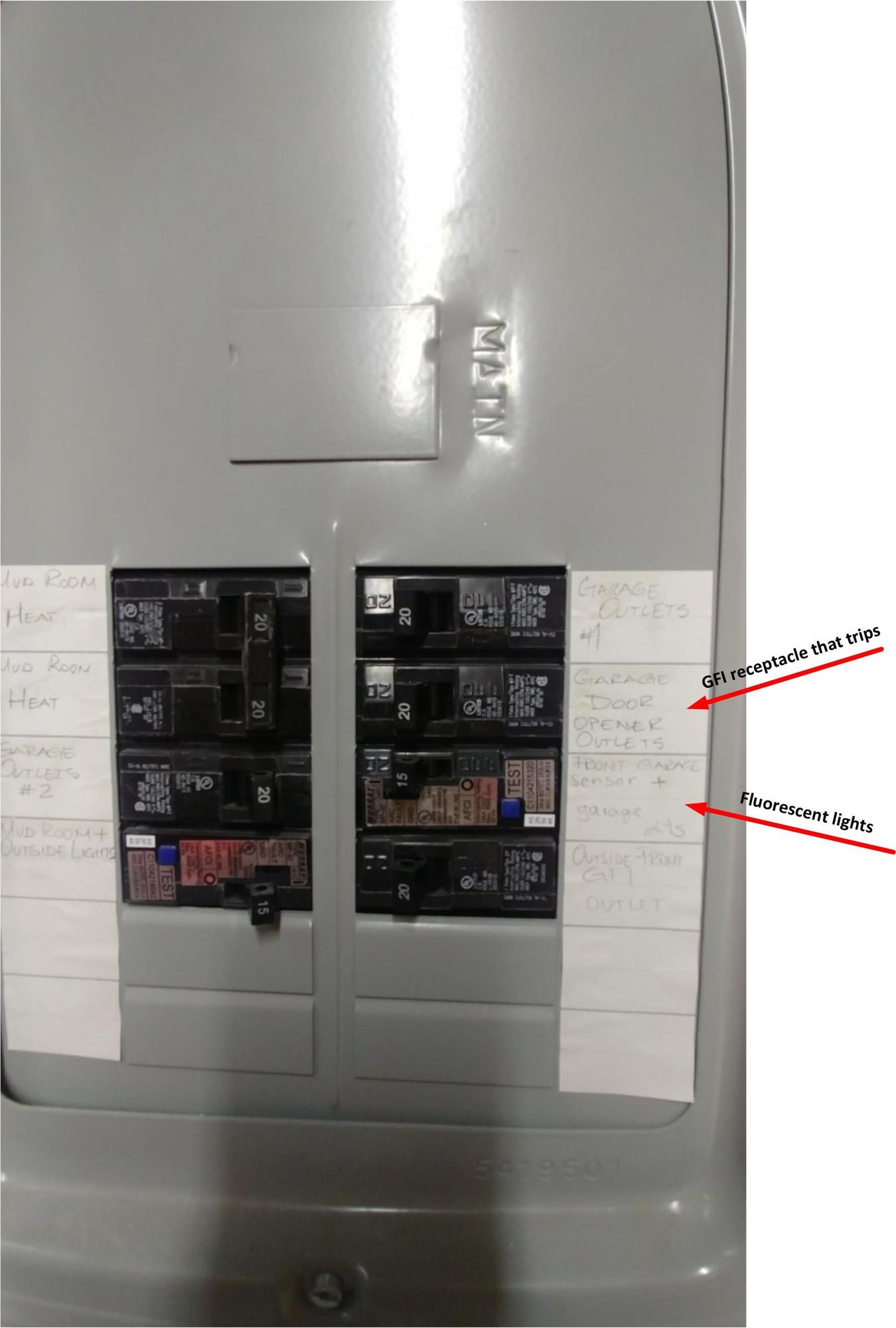

Hi! I have owned my house for about 6 months and have an issue in my garage. What I'm finding is most times when I turn on the garage lights a GFI receptacle on a different circuit trips. The garage has two very large (8' long, I'm guessing?) fluorescent lights, each with 2 bulbs. I have found that - except when it is cool, maybe below 45 degrees - turning on the lights trips the GFI plug. The two lights come on 1-2 seconds apart (always in the same order), and it is always the second one (never the first) that trips the GFI plug. Resetting the GFI plug normally always works (whether the lights are on or off at that point). The garage has a sub-panel (picture attached). The lights are on an AFCI breaker - no idea if that is related. None of the actual circuit breakers ever trip - just the GFI receptacle. I have completely swapped out the GFI receptacle (and checked the wiring) - exact same thing still happens. Help! Thanks - Rob.

Since they are on separate breakers they should not be tripping the GFCI receptacle. I suspect there is something miswired, perhaps the two circuits are sharing a neutral.
I can't read the label very well, does the AFCI say something about a sensor? If you turn off the receptacle breaker will the light still work?
It might also be possible that the lights are old, and are in fact, leaking current to ground.

Thanks for the reply! The label says "Front Garage Sensor" - I believe that is an outside light that works on a motion sensor (probably not related). In terms of the lights, if I turn off the AFCI breaker then they do not work (makes sense - since that's the circuit they're on). If I turn off the other circuit (that the GFCI receptacle is on), then yes - they do still work.

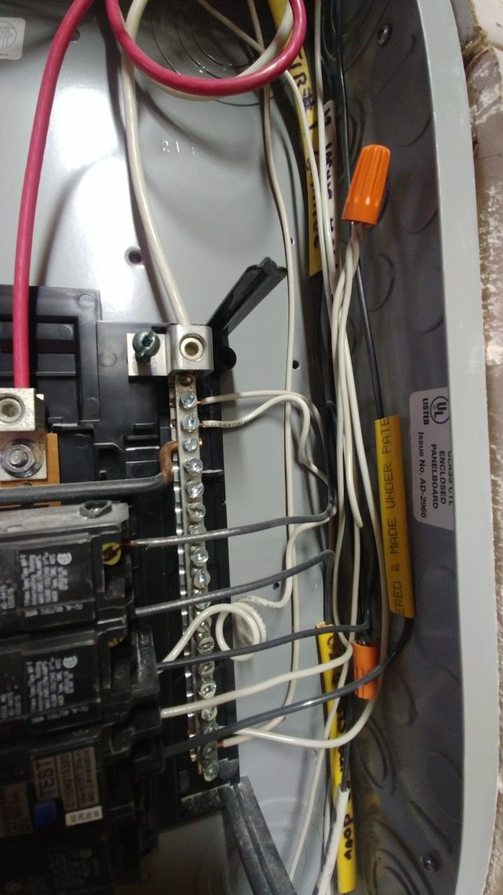

cartman AFJES - thanks for your help on this! Wondering how I might find out if they share a neutral? To my knowledge, there are not any boxes with multiple switches or outlets that are fed by both circuits.
I've attached a picture of the inside of the box. The yellow insulating casing at the bottom says "garage door outlets," and that is the circuit with the tripping GFCI. I traced the black - and it does go to the 2nd breaker from the top (on the right) - so that looks correct. The neutral for that circuit ties into the very top-most connection on the neutral bar, so it doesn't appear it has anything to do with the AFCI circuit?
FWIW, the AFCI circuit has 2 neutrals tied together - I'm assuming (?) that is correct wiring?

Did you swap out the GFI with a new unit, or just swap them around with one of the same age and possibly brand?
Just asking because when we bought our house, a lot of the GFI's did nuisance trips. After I started replacing them I realized they were all the same model/brand.
As for the neutrals being wire nutted together, that could just be to save spots in the neutral bar. (And I believe acceptable)

You need to trace the wiring from the load side of the gfci outlet checking for a shared neutral, not between the panel and line side of the gfci outlet.
